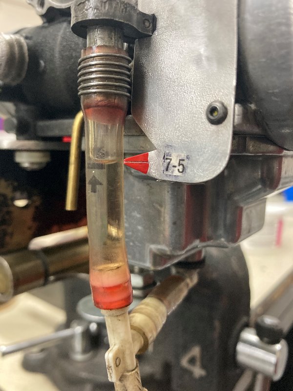

Been asked a couple of times recently how I pre-set my Brass Floats to 7.5mm consistently. The metal attachment at the top of the tube fits into a notch and is held in place by a magnet.

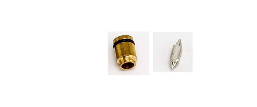

There are 2 flow paths for the gasoline to enter the float bowl. The obvious one is past the needle and seat when the needle is open. If there's still leakage past the needle seat, it may be debris stuck to the seat or needle. The float needles should be a steel needle although I have seen Viton tipped needles in the past and they can wear and leak and should be replaced. If they are steel needles then I like to polish them with Autosol metal polish and also polish the brass seat with a Q-tip and Autosol. Then clean with Lacquer Thinner.
But in your case with all 3 leaking I suspect that the second flow path is what's troubling you. If the o-ring on the brass needle seat has shrunk due to ethanol in the gasoline, then gasoline is passing around the needle seat, between the needle seat and the carb body. You need to replace those 3 o-rings with new ones and I suggest you find an o-ring dealer that can supply o-rings in Viton 75 rather than Buna-N nitrile. Viton 75 handles the ethanol better than Buna -N
Viton 75 O-ring for the Needle Seat Body 7.5mm X 1.5mm (as seen in attached pic)

Further to kawboys comment: If the bore that the valve body fits in to has been aggressively cleaned to remove scale/debris, the surface can be damaged - allowing fuel to pass by an otherwise good o-ring. It may seem like a good idea to spin - with a drill - a stainless steel tube cleaner to clean-up this area but Nylon only - if this is your intended method.
If "Kits " have been installed - be very leery of the supplied needle retaining spring. Some are known to be of an incorrect shape and will cause needle travel issues and hang-ups. The aftermarket kits themselves are otherwise reliable.....or so I've found.
