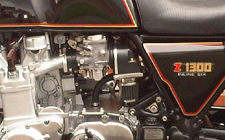

Totally agree.
If you look at the small airbox nozzle (behind side panel) those 3 mikunis are all trying to breath through on the standard airbox...........neither wonder they run rich !!
The plastic is pretty crap too & the joins in the sections are sucking in air constantly.
Ditch it & go for the modified top section of airbox with 3 filter pods. The bike runs, pulls, sounds & performs SOOOOOOOOO much better. It gives you more storage under the seat too !!
LET IT BREATH !!!!
