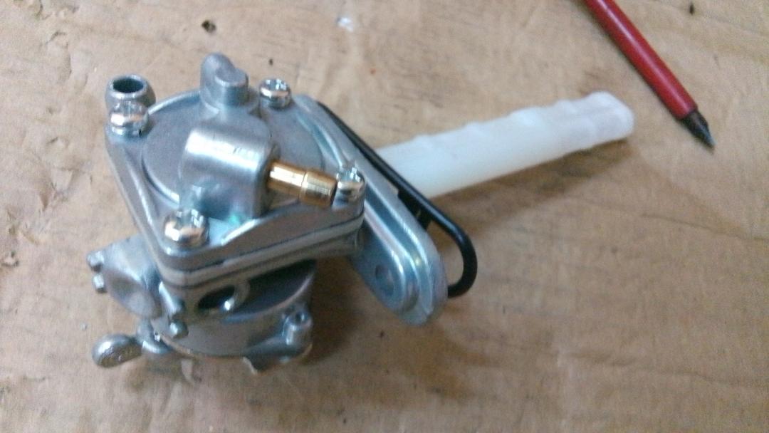

I've done it with my '80.
I removed the solenoid and replaced the fuel tank valve with a new vacuum valve.
This way you ensure that it remains closed when you stop the engine.

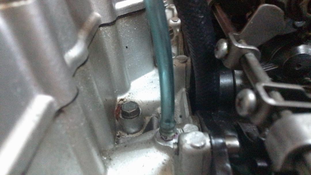

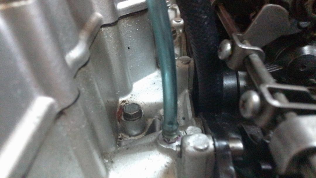

Remove a bolt from the intake manifold to connect the tube and create the vacuum line

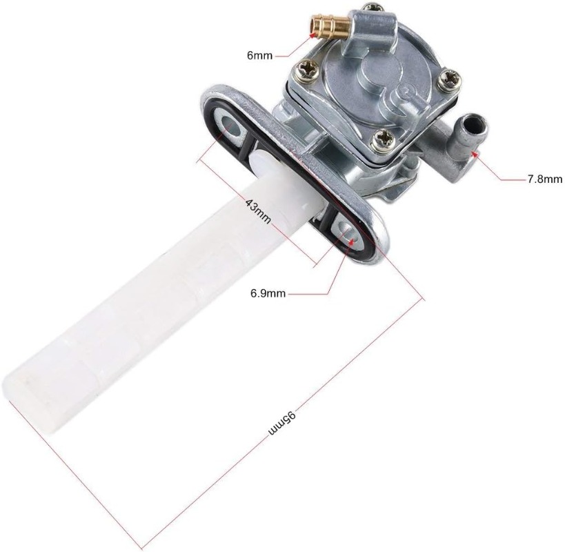

Is from Suzuki parts.
For SUZUKI GS1100 GS1000 GS300 GS450 GS550 GS650 GS700 Petrol Fuel Tap Petcock
www.amazon.com/KIPA-GSXR1100-GSXR600W-44...-28A02/dp/B078XBZ5XX
