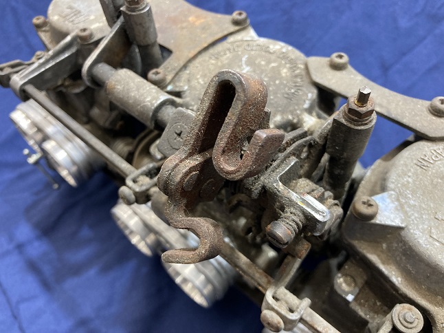

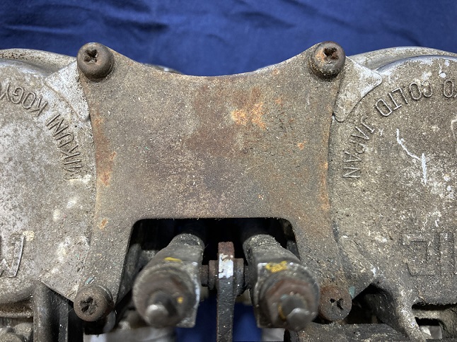

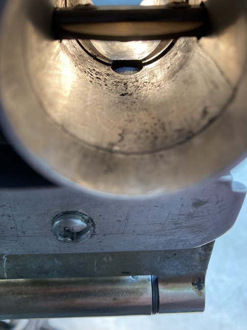

From the same carb. (set) as the OEM Float Damage:
Must have been some "nasty water" sitting for some time to do this damage. The same cause of this corrosion seized (welded) the Pilot-needles. Broke off both heads even after several days of penetrating oil, solvent soaking and multiple applications of heat ! Either/or....this carb-body was a write-off !

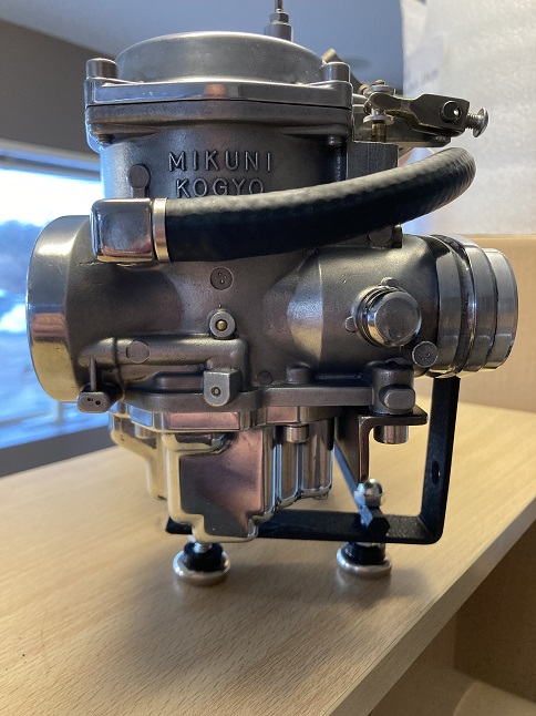

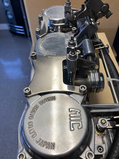

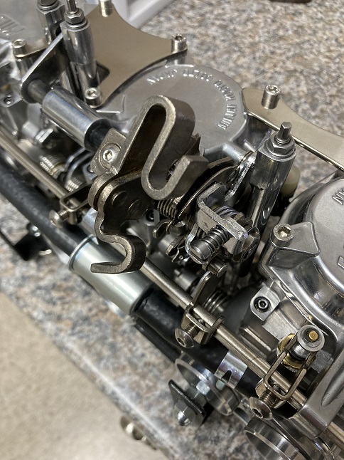

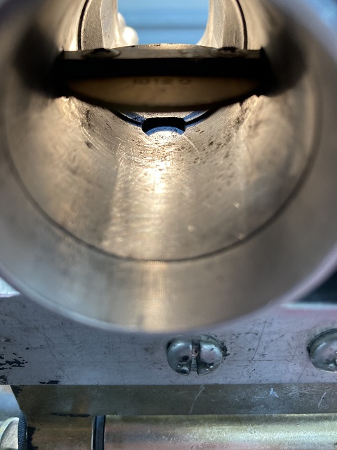

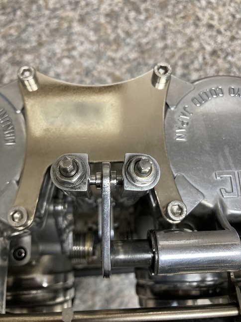

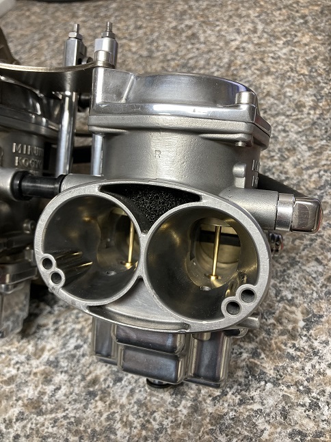

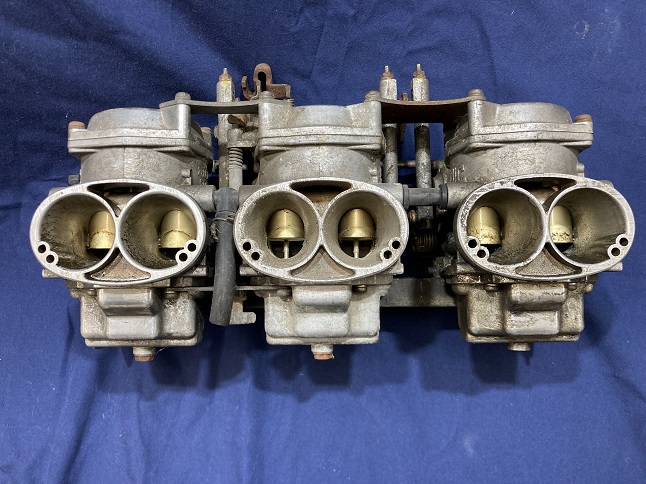

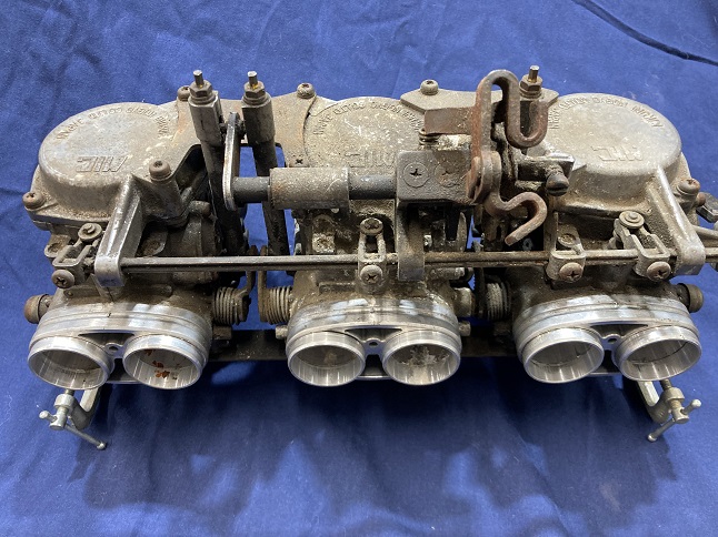

What I had to work with;
Finished:
I nickel-plated most of the hardware ( in my shop)
"Over-flows" installed
Nylon fuel-drain bolts
Extended Idle adjust
Polished venturi's and throttle-plates plus my usual enhancements - Might get 60MPG from this set !
Yes ! That is a piece of (air-filter) foam in the air-filter side ( between the inlets) Not to "filter" air. Only one other person will understand this !
Finished:
