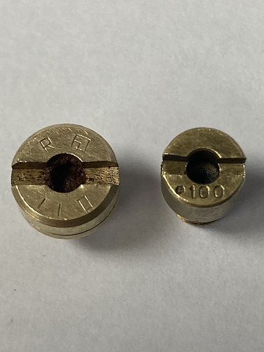

I received another EBay set of carbs today and unlike the last set, these ones are in very good condition and everything came apart with no trouble what so ever.

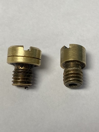

First thing I noticed were the Main-jets. Not "Mikuni".

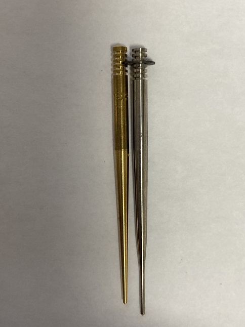

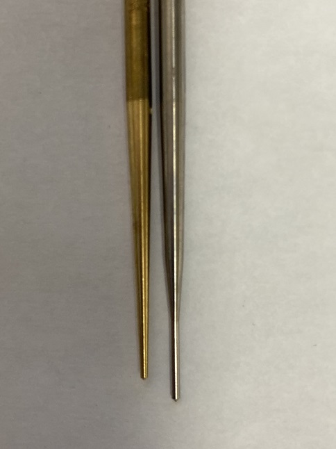

Then found these: A significant "stepped" taper, 6 slots instead of the typical 5 and 2.5mm longer.

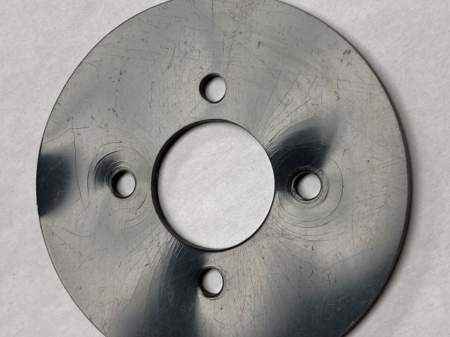

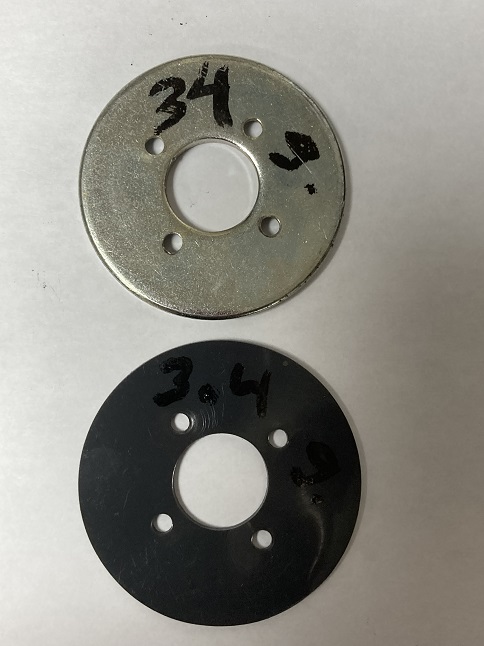

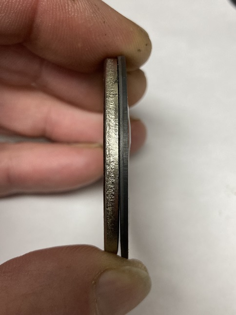

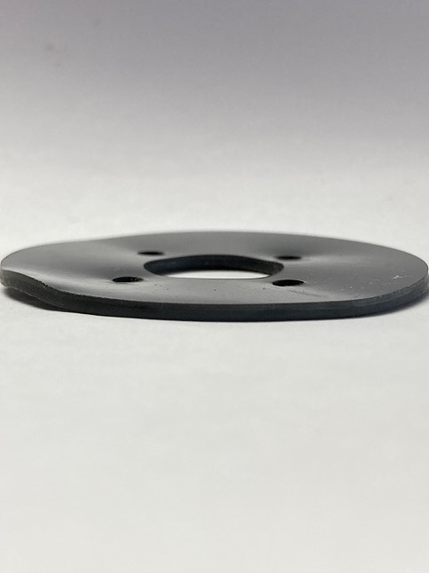

The steel plate (Sits on top of the Diaphragm) is OEM and 34 grams. The other is plastic and is 3.4 grams. A massive (relative) reduction in weight which I'll surmise is to make the entire assembly more response. Note the stress cracking and warping !

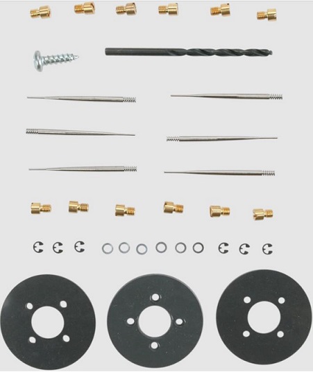

I did a quick "search" on a hunch and believe these to be a DYNOJET kit.

That 6 slot needle is interesting. Runs leaner than stock until 3/4's full throttle then rapidly reaches full flow in the last 1/4 lift. Most people think that more horse power happens when you install bigger jets when quite often, the mixture initially is more rich than it needs to be for safe cylinder piston temperatures.
Then there's the difference in weight of 30 grams between the discs. That would allow the throttle piston valve to rise higher and quicker at similar vacuum points.

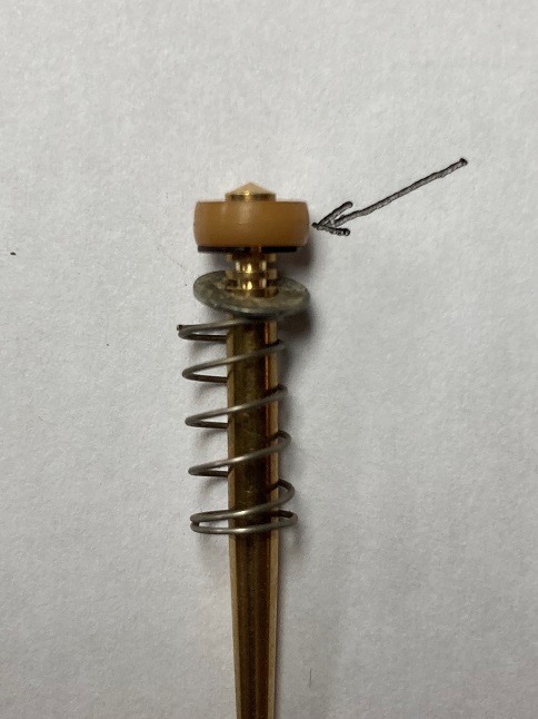

And the final(?) "coup de grâce" is:
This set had None.....not one....NADA.
There's a tiny "tit" on the bottom of the needle holder, similar but smaller to the one that registers the holder correctly into the vacuum-piston. This tilts the needle towards the air-filter side of the emulsion-tube opening. I'll speculate that this is intended to keep the needle centered when there's LOTS of air-flow striking it. Regardless: Omit this spacer (needle is now significantly higher) and that little 'tit" will now be riding on the c-clip......or not ! If it happens to align between the c-clip ends..........the needle will be that little bit lower.
It would be interesting to see an instruction-sheet from the "kit". I can't see this spacer being deliberately omitted and because 2 of the 3 the vacuum-tube spacers were missing I'll bet the missing needle spacers is an owner fuckup, as well !
Trying to tune these carbs would have been unachievable and most certainly would have driven the owner/tuner insane.
So: They'll go back to stock with missing pieces replaced and tuned accordingly.
