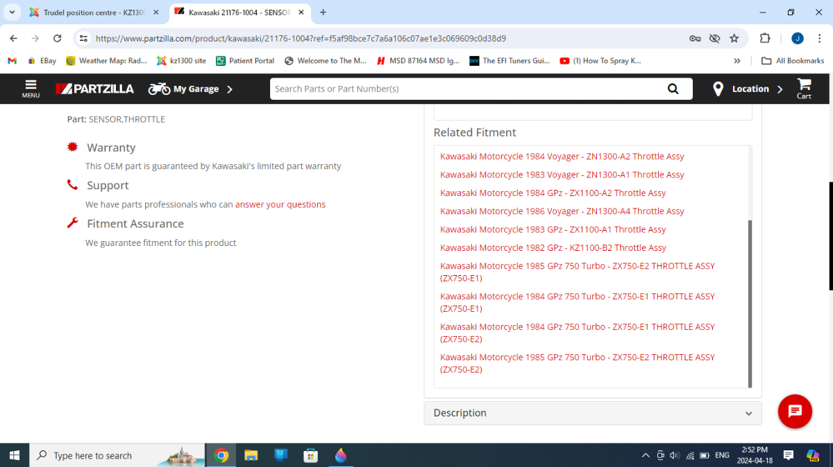

I have an 83 ZN 1300, I am trying to see if the throttle position sensor is common to any other bikes, is it common to the GPZ 1100, is it common to the KZ 1300, I would appreciate some feedback from those much wiser than myself. Thank you.

I use Partzilla for referencing information on parts. According to Partzilla, there are a number of different Kawasaki Models and years that the part #21176-1004 was used on see Screen shots I've included
[attachment=11949]throttle position sensor pg1.png[/attachment}
