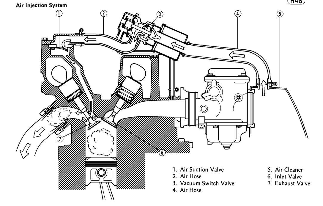

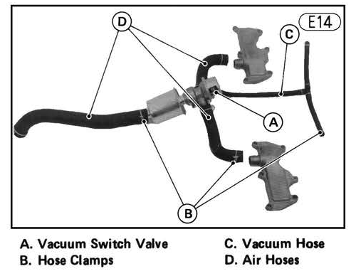

Took me a bit to find you the "correct" answer to your question in the Service Manual.
On the U.S. model there is a Clean Air System which includes reed valves in the cylinder head valve cover, a Vacuum Switch Valve, hoses from the air filter box and a vacuum hose from the #3 and #4 intake runners Item "C" in drawing E14 (see below) to operate the Vacuum Switch Valve. (All of this is covered on page 180 of the Service Manual.) Your bike may have the Vacuum switch valve removed and instead of just blocking off the vacuum ports on #3 and #4, the previous owner probably just installed a connecting vacuum tube to the nipples on #3 and #4. You can just leave it, or better yet, remove the vacuum tube and install vacuum port rubber caps on those 2 vacuum nipples.
