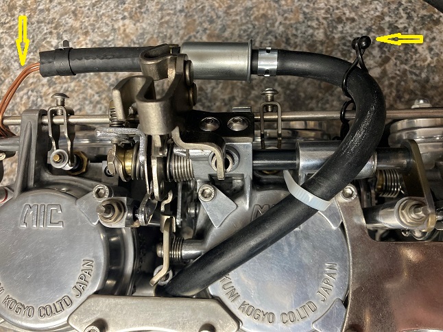

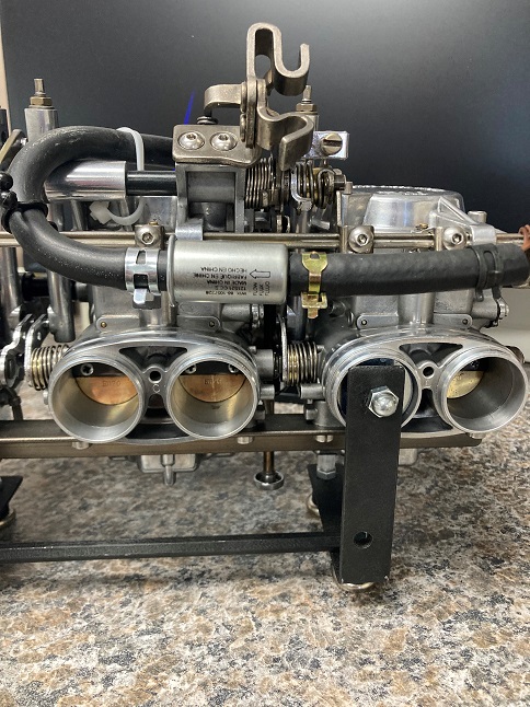

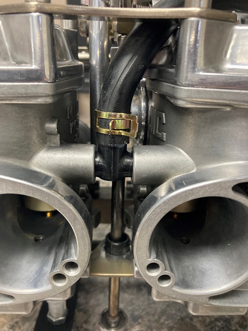

For the "Gazillianth" time:
www.kz1300.com/index.php/carburators-fue...rbs-act-up-too#16619
If fuel starvation is a concern, there is not a fuel-line configuration that's is as short,direct or less complicated.
Use thin-wall non-reinforced fuel-line.
Ignore the "arrowed" retainers. They were used merely to hold the fuel line in their correct position for the purpose of the pictures.
The White cable-tie is a suggestion to avoid any conflict between the fuel-line and the linkage.
