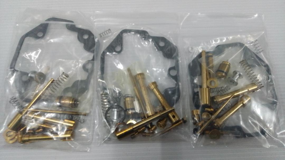

Try disassembling and cleaning the carburetors, follow the SCOTCH tutorial, he is a true eminence on this topic.
CARB REBUILD BY SCOTCH
I ended up buying a repair kit, it didn't cost me much money.
DAMINEDING KIT

These kits appear to the "generics" sold on EBay and if they're the ones stated as being made in Taiwan, you're good to go ! I've been using them for years in many carb-sets I have rebuilt and they are GOOD !
Although ''79 carb rebuild" article is outdated in some details the premise is clear. CLEAN, CLEAN, CLEAN !
I don't have anywhere near enough info about your bike so won't make any efforts to advise over and above what's already been posted, at this time.
