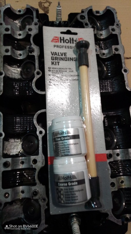

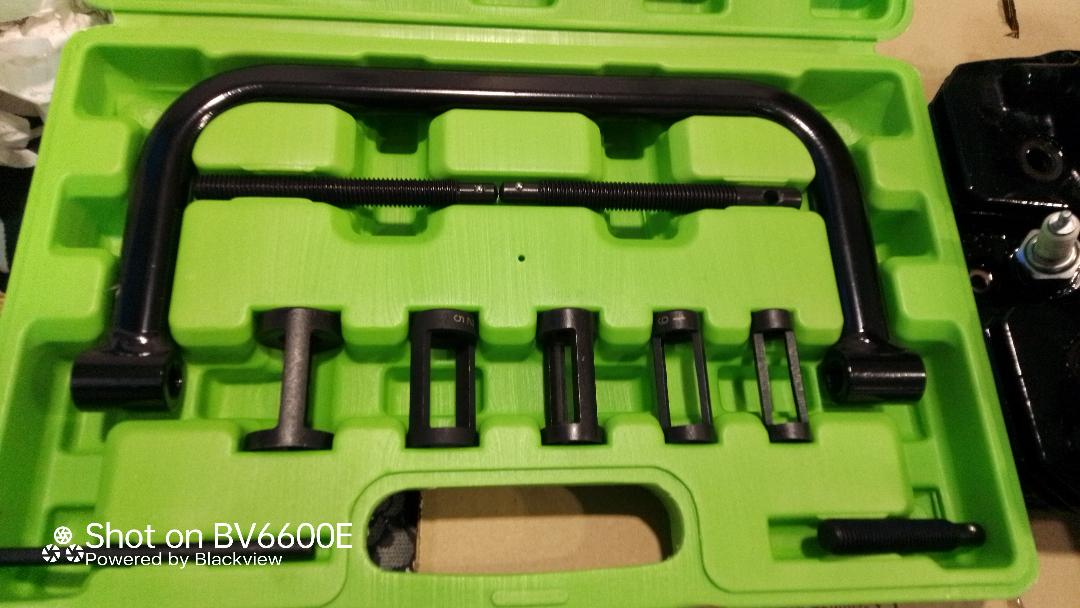

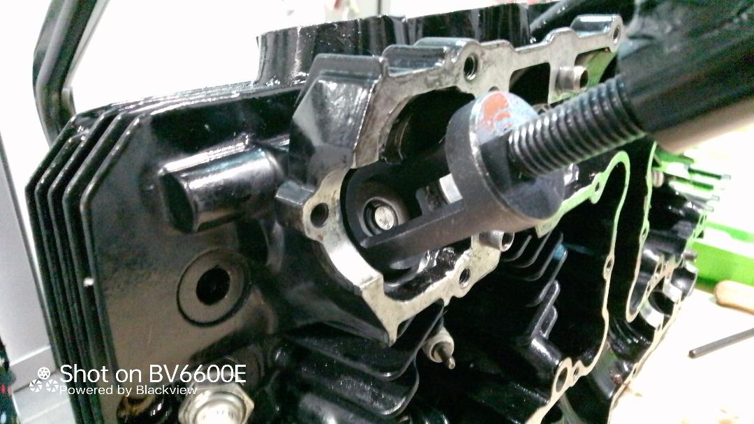

I asked Santa Claus for a valve spring puller.
I have to admit that it works perfectly, its use is simple.

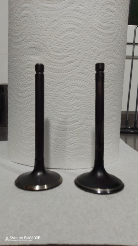

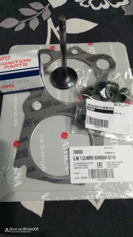

The intake valve on cylinder 4 was slightly bent and did not close properly.
So I was forced to order a new valve, I took the opportunity to order more parts such as a head gasket, shims of various sizes, a valve seal set and a valve seat grinding kit.
Getor.de has been the supplier of these spare parts.
At the beginning of the year I received the parts and got to work.
I replaced the bent valve, the one on the left in the photo, its curvature can barely be seen.

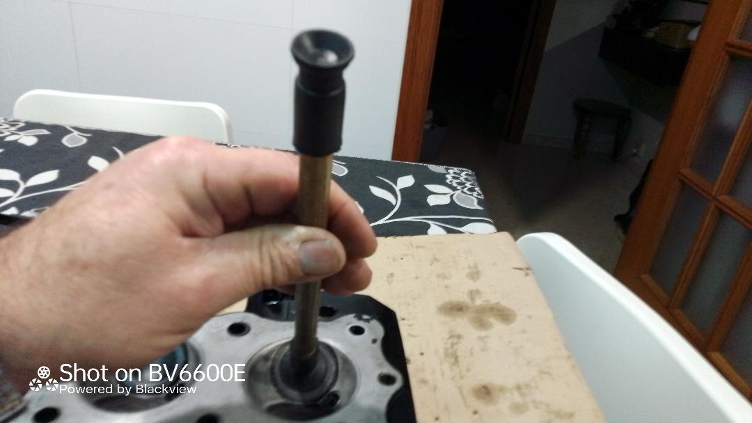

With the valve seat grinding kit, a couple of YouTube tutorials were enough for me to understand how to use it.

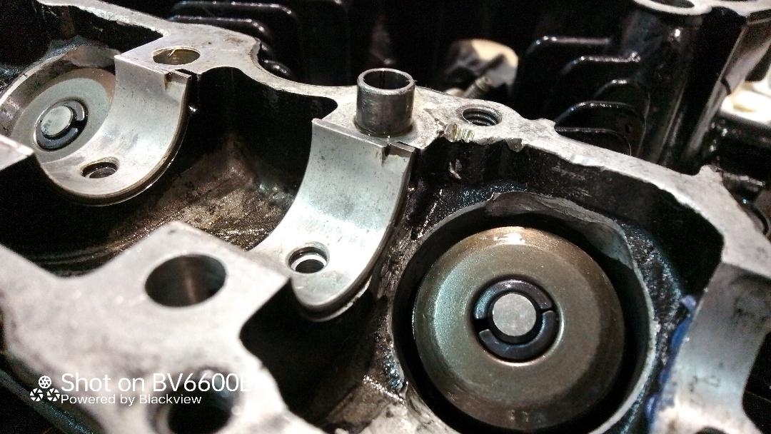

Strange that just one valve was bent. If the cam timing was incorrect, surely there would be more damage.
I didn’t know that the engine had shell bearings for the camshafts. I thought all Japanese motorcycle engines had camshafts running directly in the cylinder head casting.

1 year 4 months agoThe engine was completely rebuilt without being tested, I suppose that when installing the valve they did not notice the small curvature.Strange that just one valve was bent. If the cam timing was incorrect, surely there would be more damage.
The Z 900, Z 1000 and Z1100 have seat bearings on their camshafts from what I have been able to discover.
My Z 650 and Z 1300 do not have them.

1 year 4 months ago - 1 year 4 months agoThis valve got bent when the previous "mechanic" was installing the camshafts and setting the timing of the camshafts. The GPZ1100 is an interference engine just like the KZ1300 and I'm sure that the Service Manual for the GPZ has similar detail for the installation of the camshafts as the service manual for the KZ1300. The Service Manuals for the KZ1300 covers this aspect in detail starting on page 66 and failure to follow the steps EXACTLY as written will cause you to bend ONE valve, where as having the cam chain jump a tooth when the engine is running will cause more than one valve to get bent.The engine was completely rebuilt without being tested, I suppose that when installing the valve they did not notice the small curvature.Strange that just one valve was bent. If the cam timing was incorrect, surely there would be more damage.

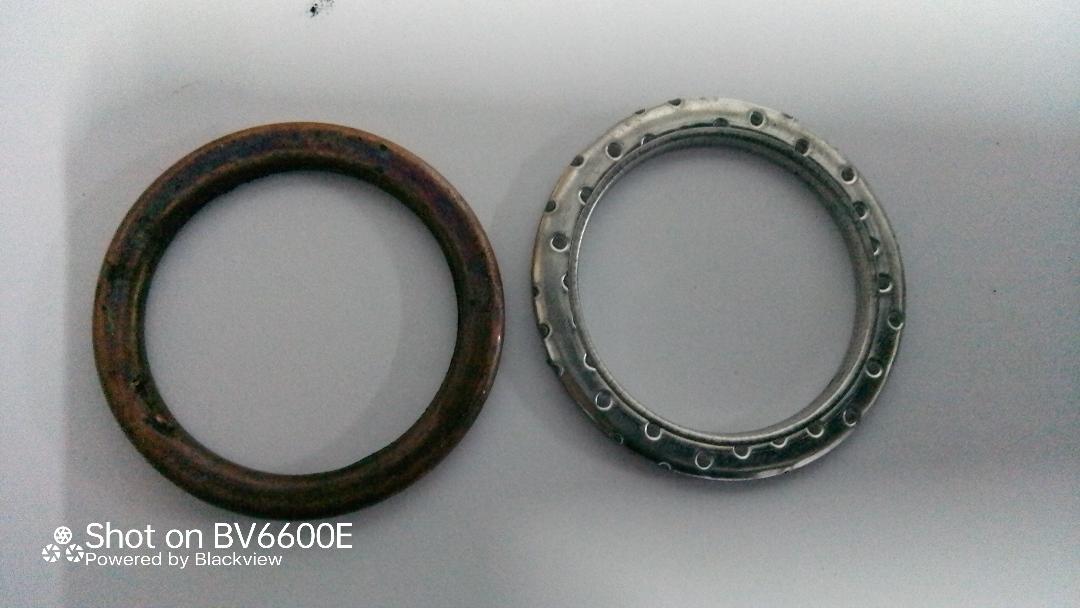

Just when starting I see a little smoke coming out of the exhaust gasket of cylinder one, I put my hand and feel some compression escaping through the gasket, that is the cause of the noise!!!

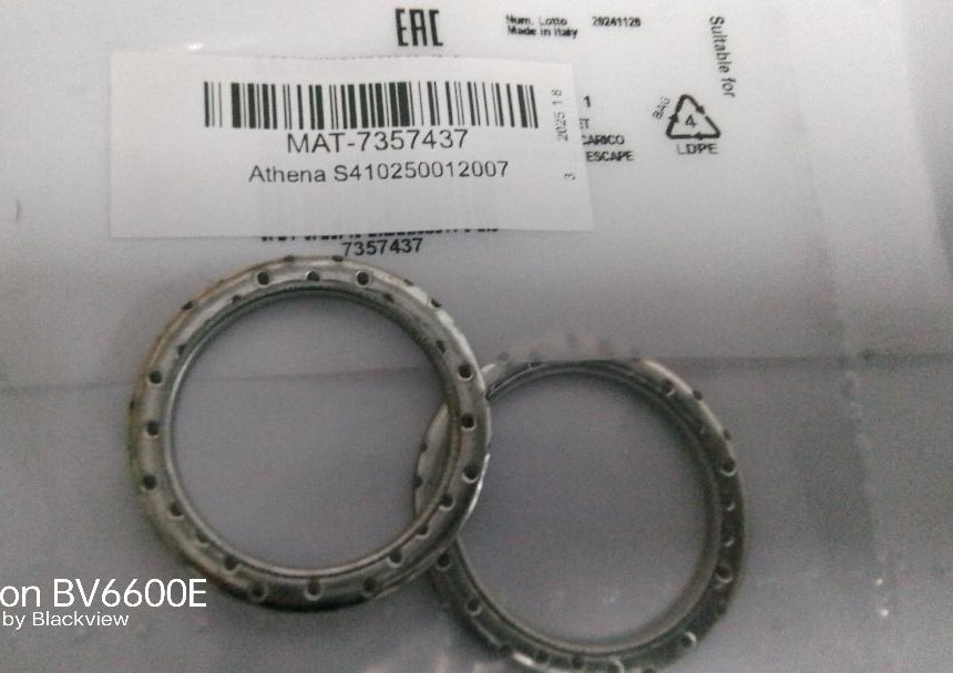

I remember that when assembling the exhaust gaskets the old ones looked very crushed, the screws on the exhaust flanges are tightened all the way and they no longer give any more strength.
I take out the exhausts again and see the gaskets that have already passed away, so I order new ones and an improved model from the people at Getor.de.

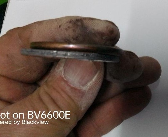

These are the new gaskets.
On the left is the used one and on the right is the new one.
You can see the difference in thickness in this photo.
