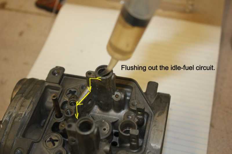

Need help. I'm obviously, not capable of figuring this out on my own.
I have two carburetor racks. One is original equipment, the other one from eBay.
I have cleaned both numerous times using the scotch tool, syringes, compressed air.
The best I can tell, all passages are open, including the pilot jet transfer, the ones that run at a 45° angle to the pilot jet from the bottom of the emulsifier fire tube.
Having said all that, I still don't have any real adjustment, if any when adjusting the pilot jets.
I have had both racks on and off at least a half dozen times now.
One lucky time, everything worked great! Every pilot jet had adjustment, the engine would stumble when closed, and in RPM would pick up when the chat was open to about 2 3/4 turns.

Went to adjust the pilot jets and now none of them, none, have any impact on the engine performance across the entire adjustable range.
In a earlier post, scotch was nice enough to reply and provide insight about the difference in vacuum levels between the engine side of the butterfly, and the air box side of the butterfly. If I understand it correctly, the engine site has much more vacuum for running the needle, jet and main jet. This value is measured in inches of mercury. The other side, of the butterfly, which creates a siphoning effect is what provides the pilot jet circuit with fuel.
Finally to my question, is it possible I have the synchronization incorrectly set, which is preventing adequate inches of water vacuum to enable the pilot jet circuit to provide fuel? I know that the air passages are clear and open as proven by spraying wd40 from the pilot jet and can see it escaping from the inlet passage at carb mouth, air box side. IIRC, the bottom hole.
At this point, the bike is running great, idles smooth and nice and has beautiful response from idle to redline, so I am reluctant to mess with them much more. Even at that, I'm very curious about why that one time I had pilot jet response across all six, other times I've had four out of six or five out of six, and now, zero out of six???
