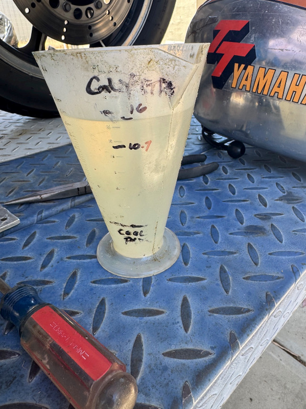

I ran two timed tests yesterday using the smart phone clock and a RatioRite measuring cup.
Test one was with the tank about 25% into Reserve, with the Pingle in reserve position. Here's the result.
~15 Fl Oz in 30 seconds, acceptable. Even good, perhaps, given on Reserve and associated reduced head pressure.
I was all happy n' crap with results, then the thought crossed my cranium scarebellium...
"The Pingle has two separate flow paths, Normal and Reserve. You were on 'Normal' when running at 5k prior to shutting the engine down and pulling plugs for readings."
Acck!
Of course, this was AFTER I already had buttoned everything up, removed bike from lift, placed into trailer for ride today.
Science, of course, requires due diligence so back on the rack for the "normal" test.
This time, the entire Ratio Rite filled to the tippity-top in less than 20 seconds. Way plenty fuel.

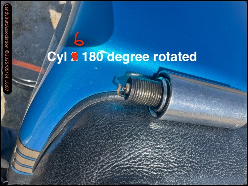

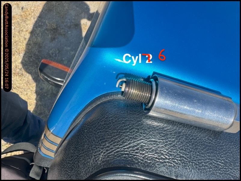

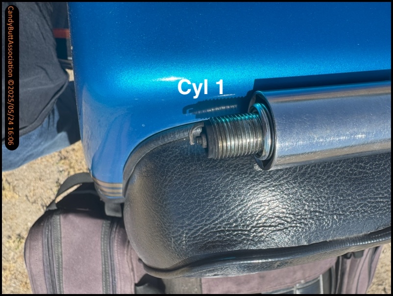

Just for a lark, installed BP8ES plugs, replacing the BP6ES (colder). I don't yet fully understand spark plug heat range vs plug reading and impact of colder plugs on a lean fuel ratio.

If you look at your 2 spark plugs with different heat ranges, you'll see that the hotter plug has a longer ceramic cone around the center electrode compared to the colder heat range plug. The longer the ceramic the further the heat has to travel to get to the spark plug base to disapate the heat through the spark plug base and to the cylinder head. Hotter heat range plugs than the standard for an engine were designed for the "Granny's" out there that get in a car and drive to the corner store and drive home and don't get the engine up to temp. If you don't get the engine up to temp and run it for 10 -15 minutes, all the carbon that built up on the spark plug when the engine was running rich on semi choke would not burn off and plug fouling would occur. Hotter range plugs will burn off the deposits under light loads more so than the engineered range plug for that engine.
On the other hand, colder range plugs are used when the engine is running under full load more than cruising mode like on the race track. If the ceramic around the spark plug gets orange hot to white hot, preignition will occur causing detonation and detonation in the presence of high cylinder combustion chamber temperature will blow a hole in the piston.
With all that being said, the BPR6ES spark plugs are the proper heat range by design for the "normal" use of the KZ1300. If that's the "standard" then something else is causing the white ceramic shading of the ceramic on the spark plug. Putting in colder range spark plugs is putting a band aid on the problem and not getting to the root cause of why the bike is running so hot and bear in mind you did note that the bike was running like a Banshee like your KX500 just before it blew up and that's a true " seat of the pants" experience of preignition.

Agree with the bandaid response. Forgot to mention 2 days ago, when performing flow rate test, also checked intake boots for snugness. All appeared to be snug. Did not spray WD-40 or other flammable liquid around the boots to check for leaks. Also checked each of the 6 vacuum ports for snugness. No WD-40 test.
Rode it for almost 200 miles yesterday, paying attention to not press to hard. Yesterday's ride was more about seeing how the bike rode sans the big flat slab of plexi known as a windshield.
Unfortunately, wasn't able to replicate the 5k run, kill switch to off, coast to trailer, pull plugs trick. My favorite public parking spot which enables it had a trespasser. Don't they know who I am?
I need a more scientific l, systematic approach. Establish a baseline via consistent testing. Change one parameter at a time, observe changes.

- Bike starts easily from cold. Just a tad bit of choke, instantly fires. No cranking needed. When fired, she can run off choke at idle with just an occasional hiccup as the engine warms then settles in nicely after only 1 or 2 minutes. To me this indicates the pilot circuit is properly jetted.
- If not 'romping and stomping', the plugs come out much darker. Cylinder one is still leaking a bit of oil into combustion process, but it's tolerable. That tells me the pilot/needle jet circuit is good up to main jet / needle jet transition point. In other words, from 1200 to 4000 rpm, the plugs look normal.
- From 5k and up, on extended durations, the plugs come out white. To me this indicates too small main jet. Additionally, this is 1 overbore engine running DG 6-1 exhaust. Stock air box. Upgraded coils and wires.
