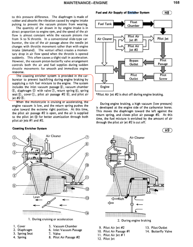

Backfiring when deceleration
  • Vacuum switch valve broken
  • Air suction valve trouble
  • Coasting enricher trouble

Hi, anyone have the instructions to remove these valves and blank off. Do i need to know anything else when carrying out this work.
Thanks Guy's in advance

I plugged passage #6 with JB Weld. At the time I was trying to correct a rich condition. Later I resolved the issue when I wet set the carb floats.

Thanks Bill, so you didn't blank off the valve with a gasket !  you plugged the one inlet vacuume  passage with jb weld !

Yes Phil,
JB Weld, which may not be fuel resistant, is what I carefully ladled into that opening.
Frankly, it didn't help. I didn't notice any difference in the way the bike ran. I'm not aware of any down side to have done so but I probably should have left it alone.
