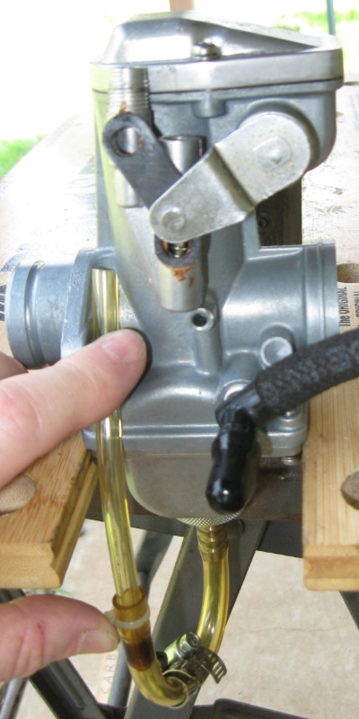

Saw this on FaceBook, Team Belbros..
Gonna give it a try!
Place carb body on top of glass, the bowl underneath the top.. Connect fuel to carb, fill the entire volume, see where
the shutoff point is?

- dcarver220b
- Posts: 1273
- Thanks: 294
Re: Carb float bowl wet adjustment tool
6 months 2 weeks ago
I like to live dangerously! That's why I have two wood-burning stoves in my shop a glass jar with 1.85 quarts of gasoline in it, working on a workbench and using authentic fingers!
Made this adapter for 79 carbs..
Haven't figured out how to for later carbs with screw, not a bottom bolt.
