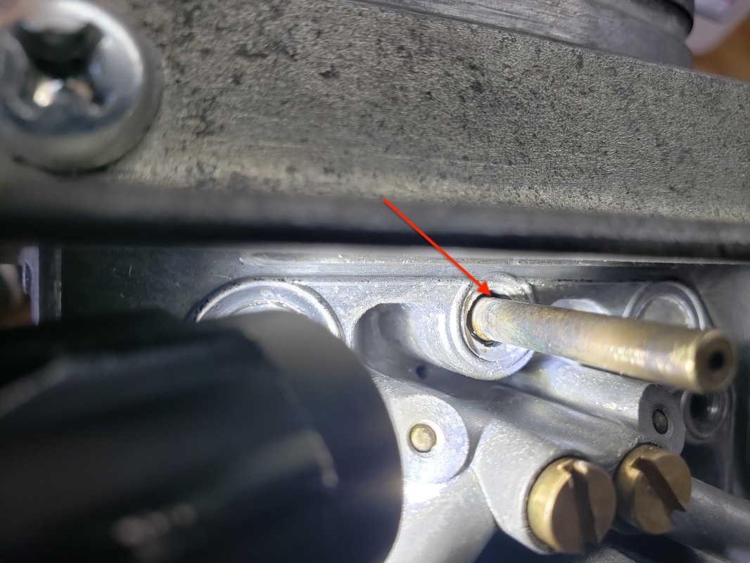

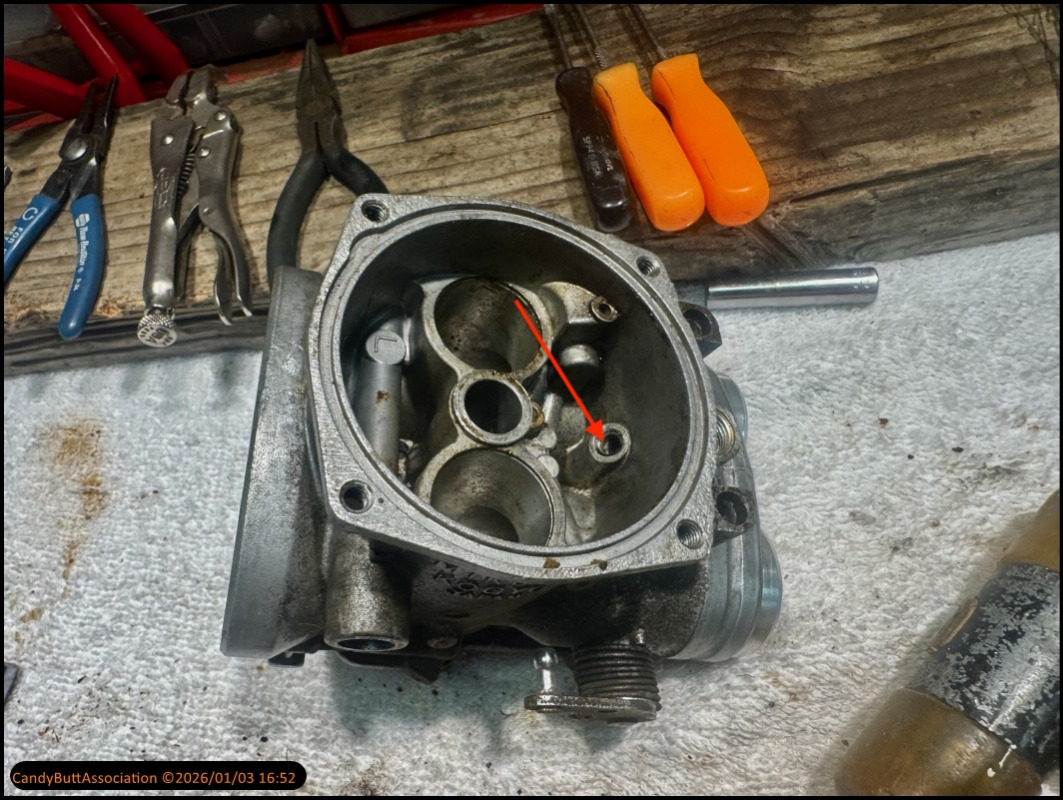

Are you seeing wetness here?
Does that pickup tube deliver fuel to this port?
If so, could one 'plug' this orfice and see how the bike runs?
Wondering about things that may raise all 6 needles to high causing richness at idle....

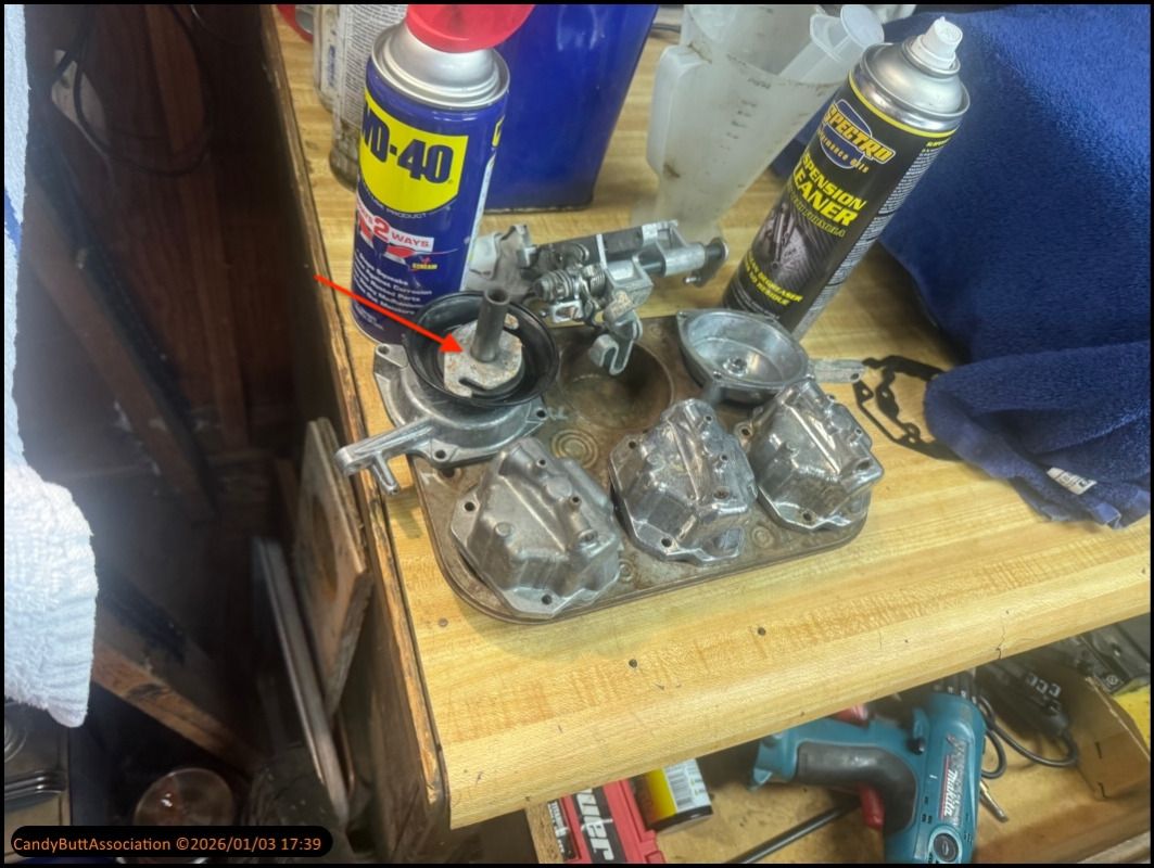

. Diaphragms installed upside down (grasping at straws)
. Too thick of washer installed here?

4 months 4 weeks agoAre you seeing wetness here?
More than wetness, with choke plunger sealed, liquid literally gushes from the pick up tube - carb body joint ( I guess, I can only see that it's coming from the well around the tube) with little pressure on the syringe.
No, that port delivers air to the starter system / choke plunger.
If so, could one 'plug' this orfice and see how the bike runs ?
Probably real hard to start.
Diaphragms are right, washer is original.
I've got 2 things going to see what happens : Replaced the original choke plungers that definitely were indented from the choke pick up orifice. and I sealed off the area at the pick up tube with JB weld. We'll see what happens ???
