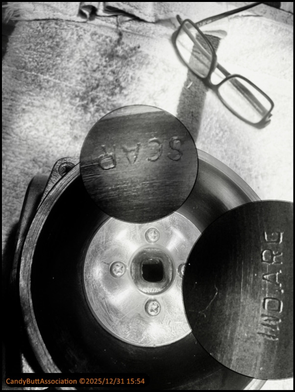

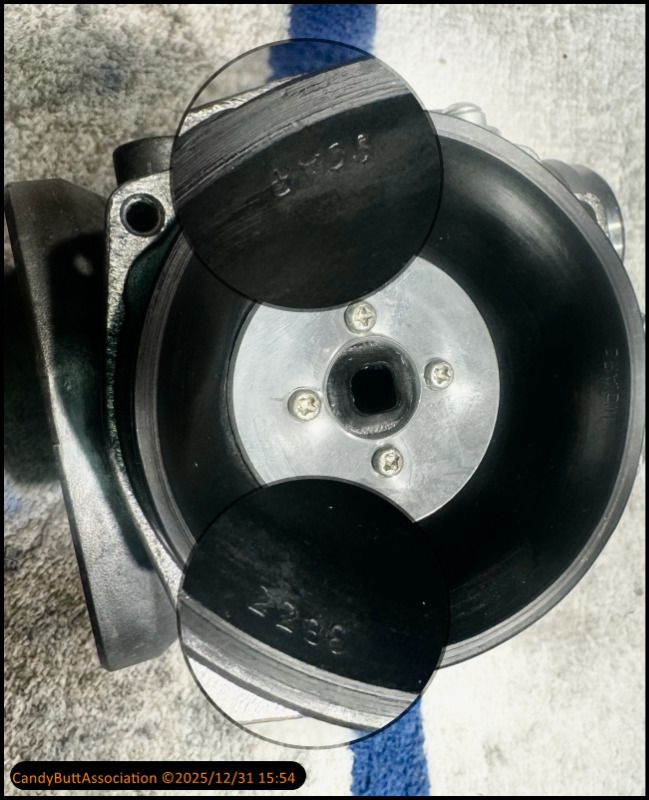

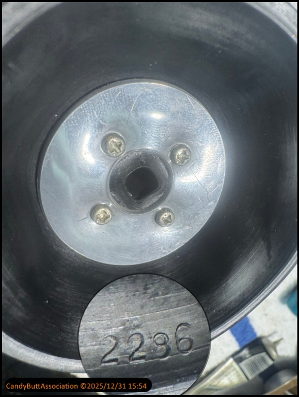

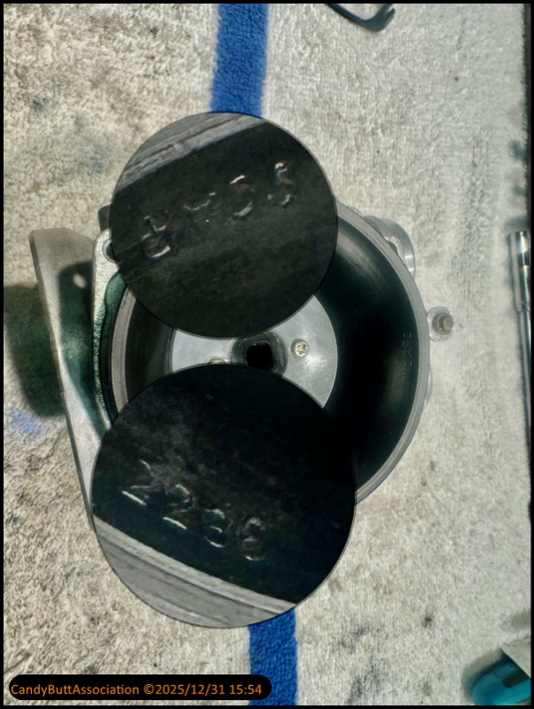

Check this out.
Some markings. Not sure what they mean.
But these are way too stiff.
recall KawBoy from Kz1300.com mentioning he had some stiffies too.
I'd not seen any of the other diaphragms I had beeing too stiff..
Until now.
Wonder if anyone has a clue who sold these..
So as to not buy!
Until now.
So as to not buy!

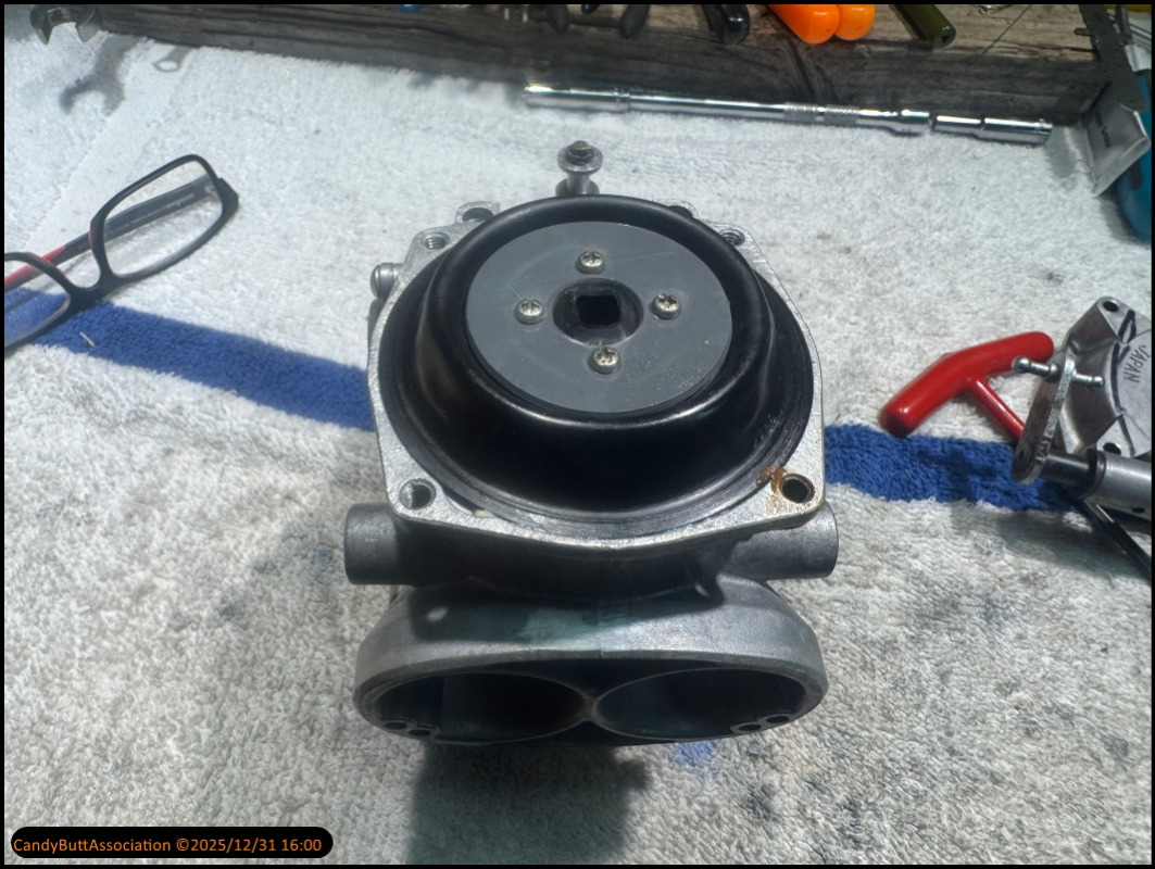

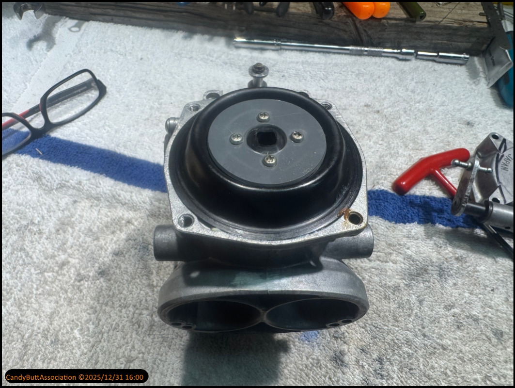

I just ran across this tonight... Any chance the diaphragm was 'upside down' as i found on this one tonight?
candybuttorg.ipage.com/cba/comment/1355#comment-1355
