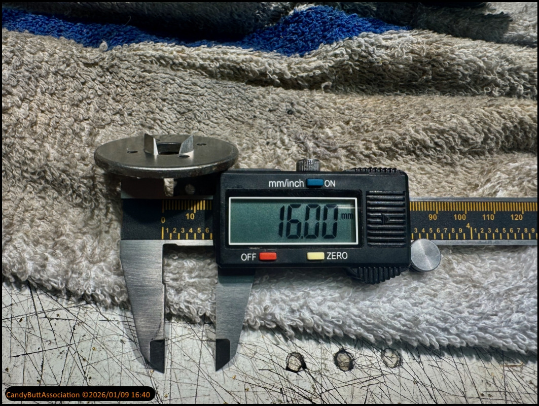

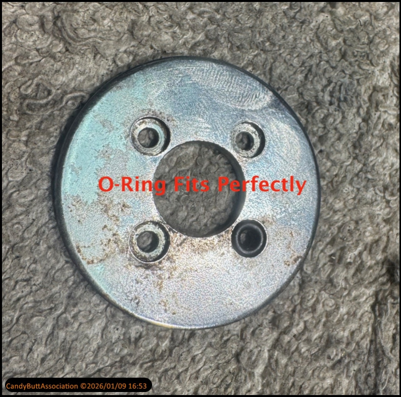

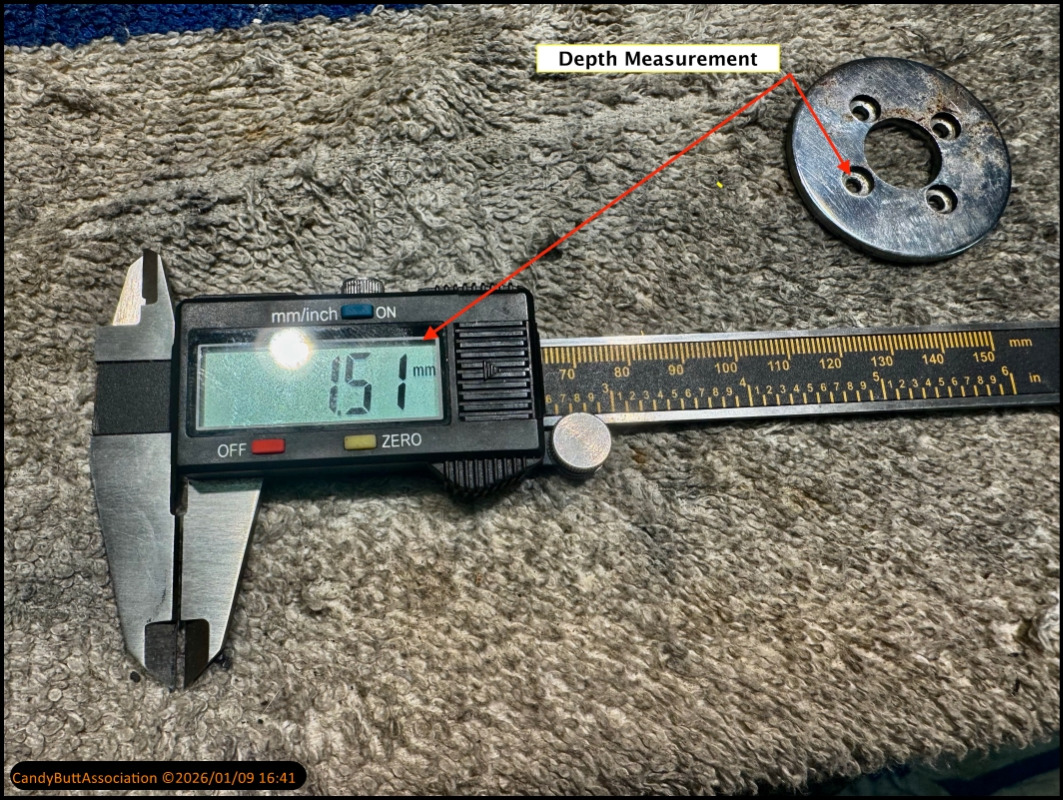

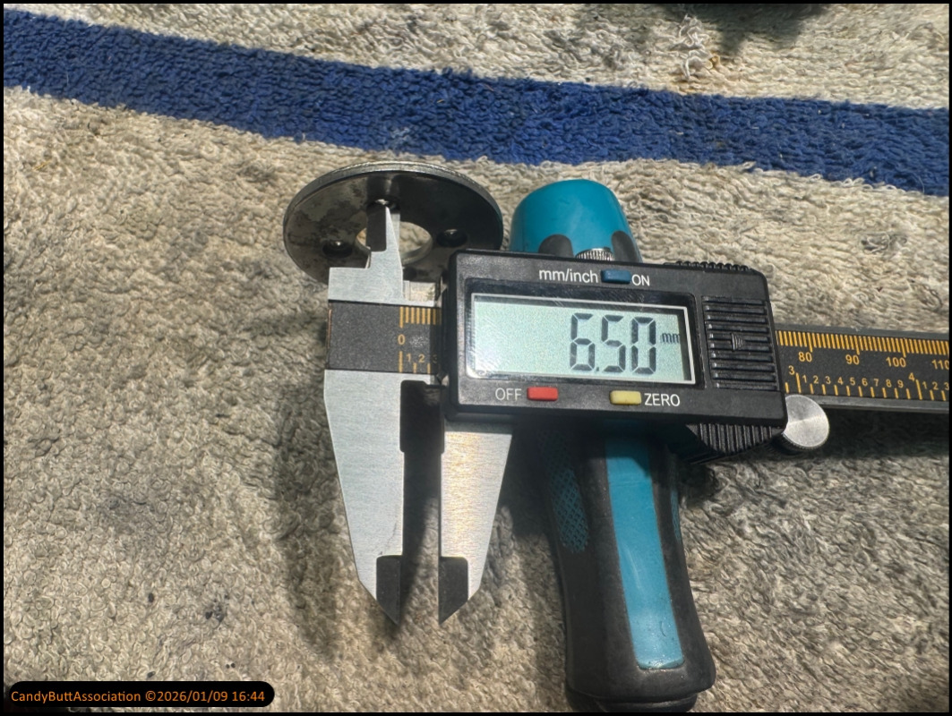

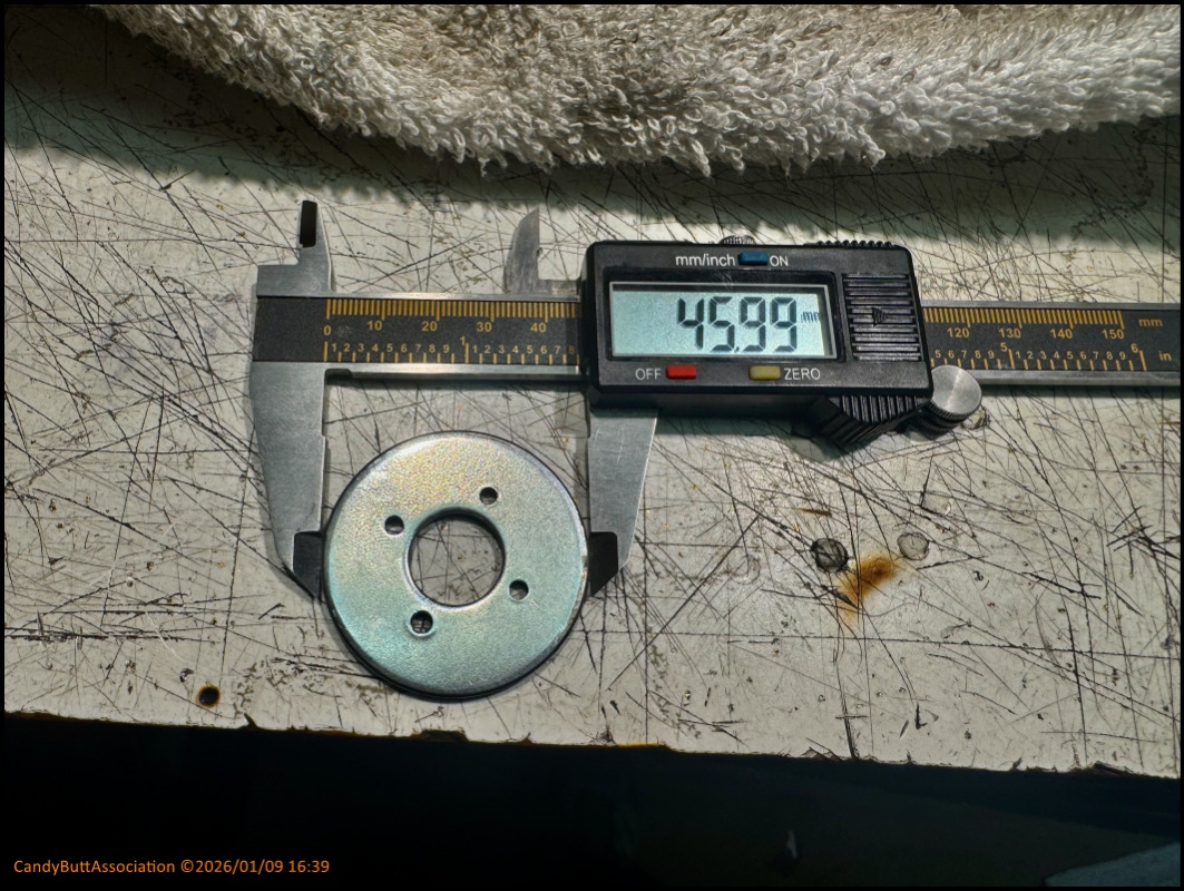

JIC this might help someone else some other time down the line....026-01-09 Kz1300 Carb Disc Dimensions
Several of my carbs have the metal disc replaced with plastic discs..Here's OEM metal disc measurements.

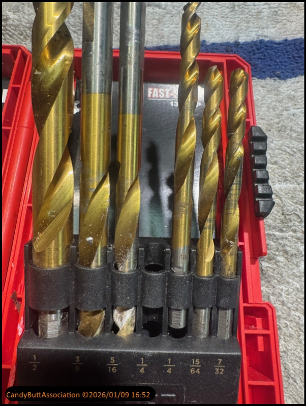

A 1/4" bit fits the hole ID almost perfectly

The plastic diaphragm plate (you show the OEM metal ones) is from a "Dyno Jet" Stage 3(?) KIT.
The lighter weight of the plastic holder provides a faster response in terms of Vacuum lifting the main-needle holders/slides.
I would advise you abandon the "o-rings" you were intending on using. A "Fiber" washer" is required........or use nothing at all !
"Lock-Tite" will seal the 4 small screws.
I rebuilt a set of carbs for someone several years ago and it was the first time I had seen and ever have seen a "Dyno-Jet" Stage 3 kit. I wasn't impressed with the "Plastic" retainer-ring. It was deformed(warped) and lifting between the 4 screws. A poor choice of materials for the application and the PRI$E !

Thanks Scotch... Good info. Passed it on to Oz at Zed-Parts as he has seen the plastic discs too and didn't know where they came from..
