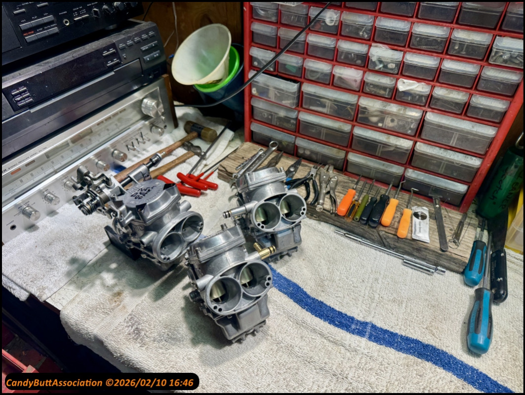

It is easy to fall into the trap of complacency.For example, I serendepitously noticed something strange about this particular used carburetor rack.
Can you identify the issue?
My little workbench.
Here's a clue...

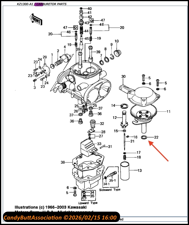

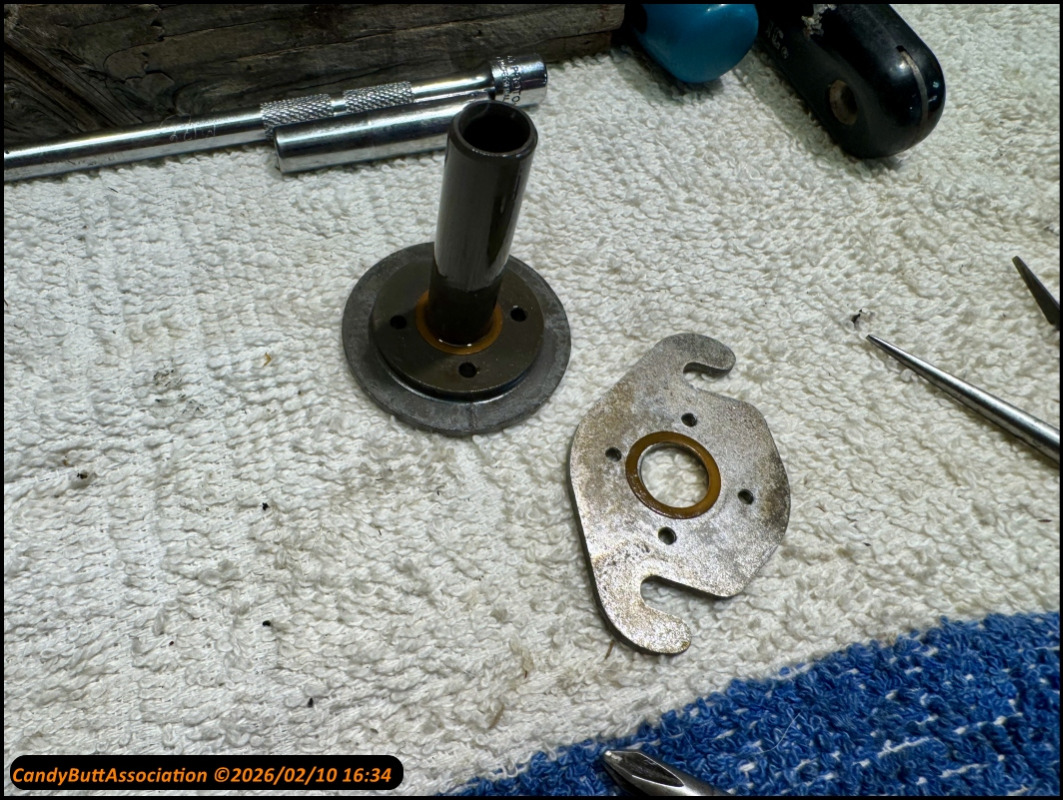

Two fiber washers?

I noticed the 2 "washers" right away which has some irony for me.  A set of carbs I bought on eBay several years ago finally made it to my bench on the weekend.  The 3 "washers" were missing !

The Eagle-Eyes are correct!
2 fiber washers...
Well done boyz, well done!
