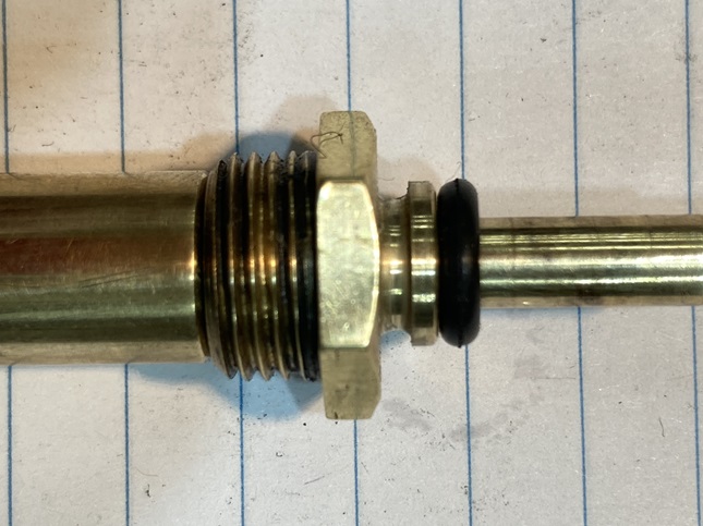

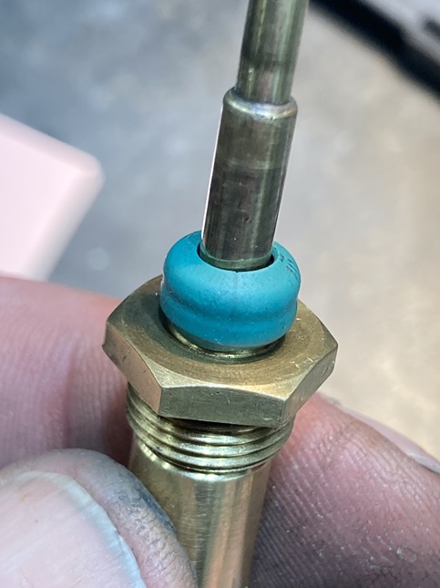

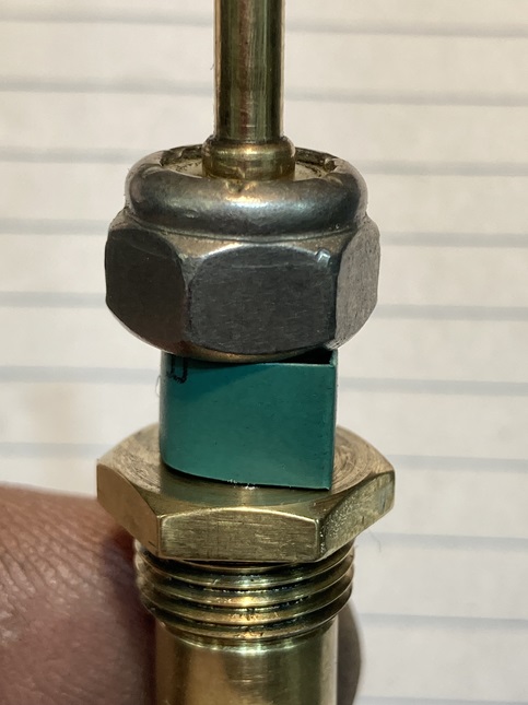

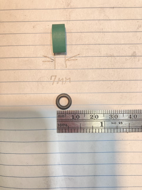

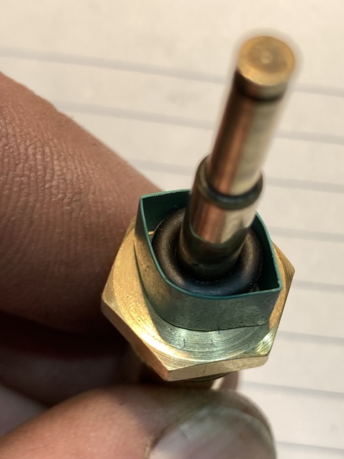

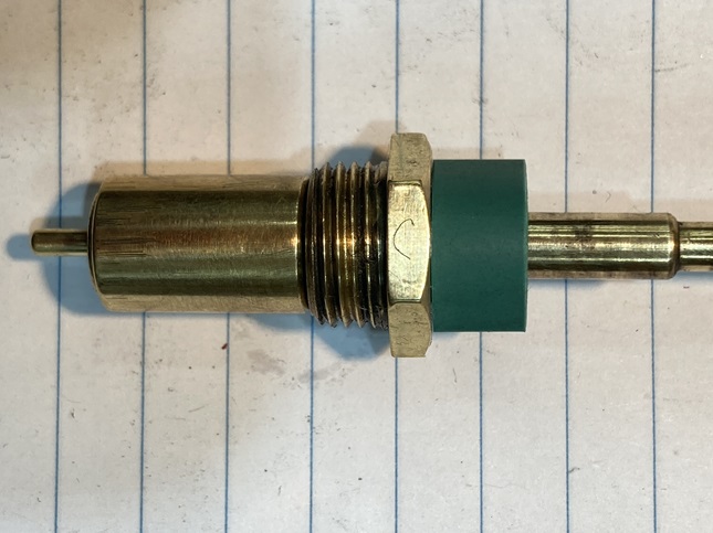

I am currently finishing the work on 2 sets of carbs. The ones that came on my '79 project were boxed and set aside until now. The '79 bike is finished and has a previously rebuilt set with some tricks and treats!
The two sets have the same issue as do most carbs. The external rubber seal that fits over the retainer nut and seals the plunger-stems are hard.
These little "boots" are unavailable from KAWASKI. Several years ago I found some aftermarket ones on eBay. They were crap. Too loose to stay secured over the retaining nut (lip) and the stem hole was too small in dia. which resulted in the 'boot" merely lifting off the nut when the choke plungers were lifted. I tried enlarging the hole for the stem but the entire little boot continued to lift.
This is what I have done to solve this issue; and before someone asks.....I didn't have "Black" and the "Viton" appearance is due to a different light source !
The nut holds the shrink-tube down, while using the heat-gun.
