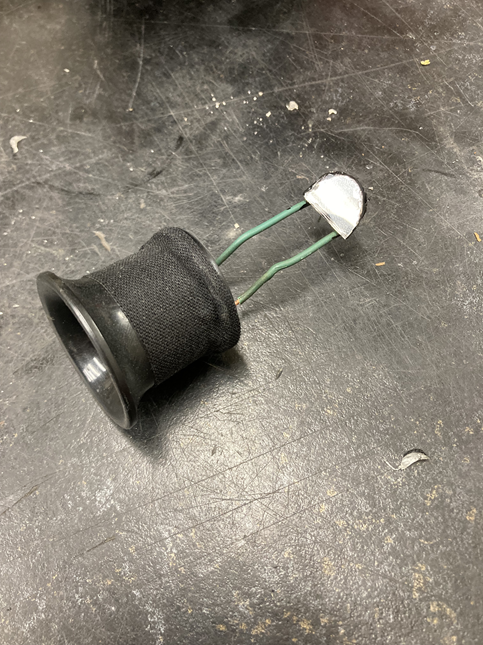

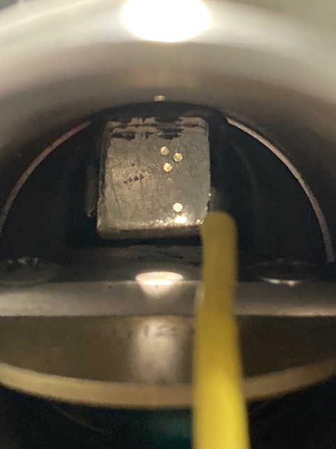

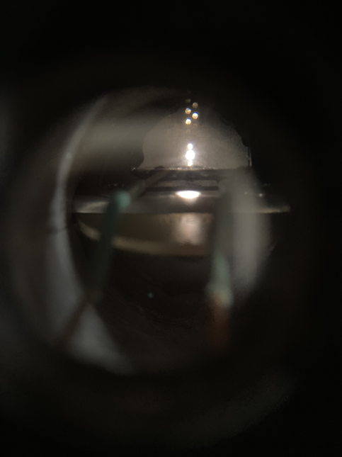

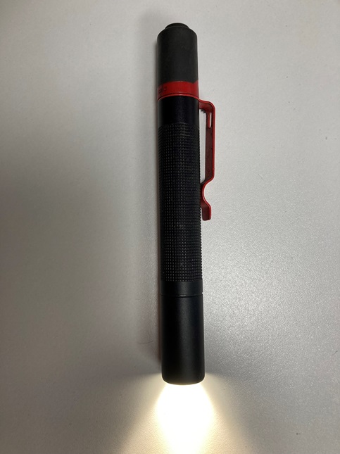

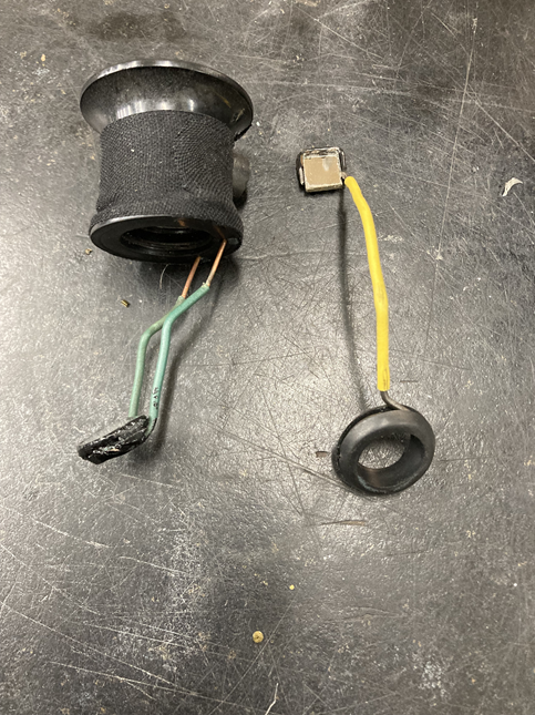

Self explanatory.  Either mirror configuration, with a high-intensity single LED pen light aimed into the Pilot-jet port  allows you to see through the transition ports and into the supply gallery.  If there's crap in the ports it can be seen with clarity.
Thanks to kawboy for the idea.
