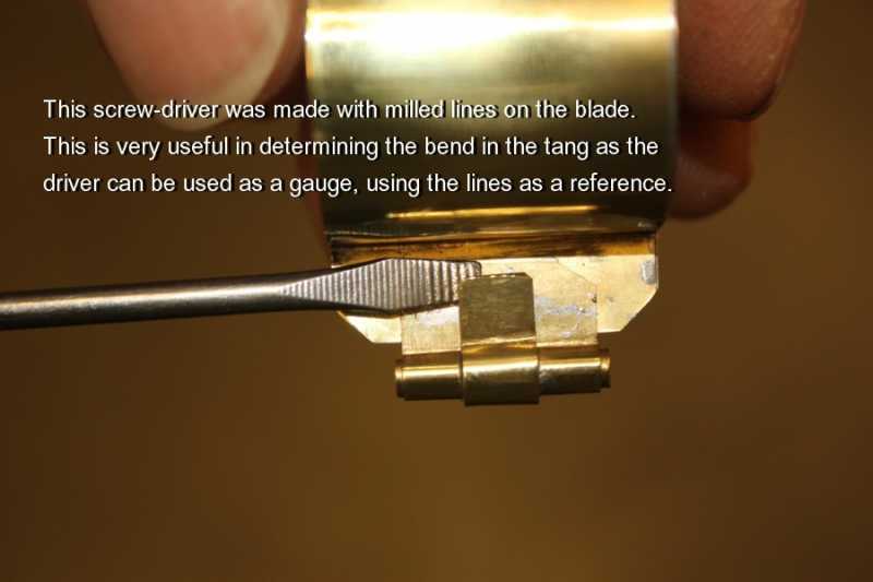

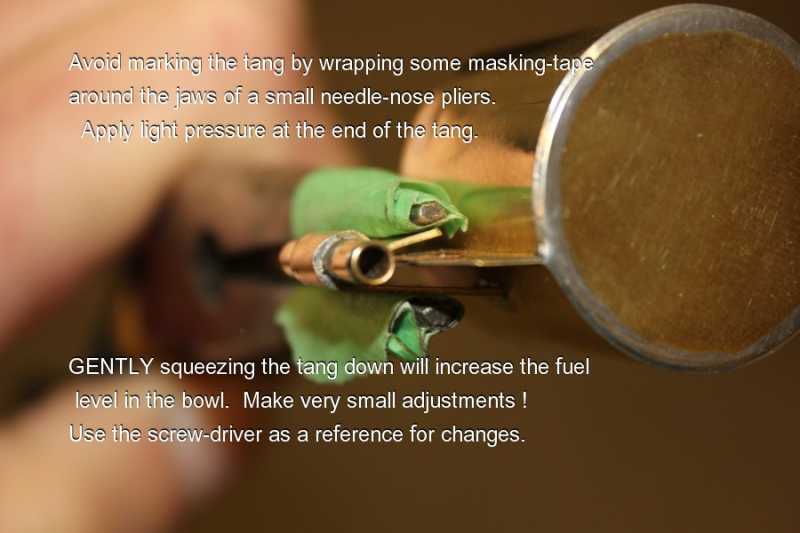

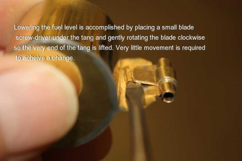

Q #2 - "How do I adjust the brass-floats to get the correct fuel-level"?
Answer - If adjustment is required the procedure is the same as for the OEM float. Note: After final assembly the brass floats are adjusted to the correct "wet" level using a "1300" throttle-body/bowl, OEM needle-valve. No further adjusting should be necessary. The "wet" fuel-level adjustment must be done "on the bench" with the carbs level. The "wet" method is the only means to set the fuel-level when using these brass-floats. NOTE: Replacing the floats will not correct or compensate for faulty needle-valves, needle valve-body "O"-rings or over pressurization from "fuel-pumps".
