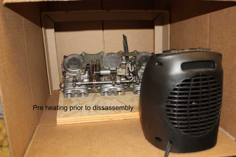

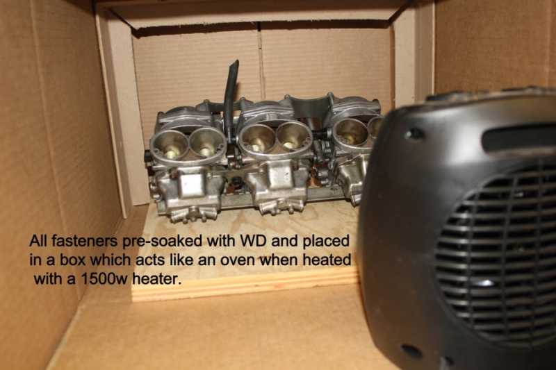

I just received a complete set of carbs from a '79 and thought some pictures and explanations of the complete tear-down and re-build may be of help to others. The pictures are self-explanatory. Part 2 of the tear-down to follow.
