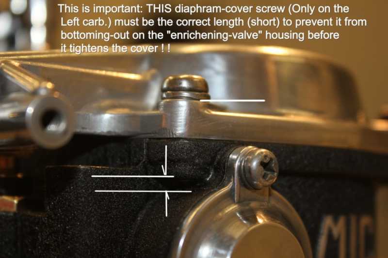

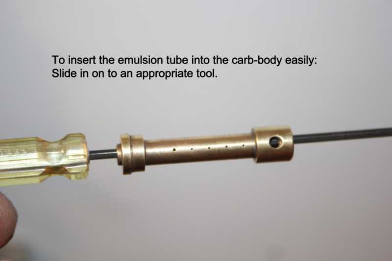

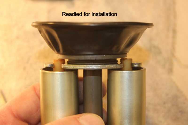

NOTE: The seals on the throttle shaft ends could be damaged if soaked excessively in strong cleaners such as lacquer-thinner. The use of lacquer-thinner for manual surface cleaning and gallery flushing using a syringe is OK.
The Tube-Cleaner is Nylon !

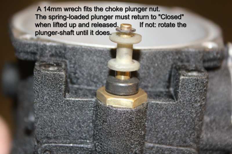

The Choke plunger Nut needs only to be "snugged" - NOT torqued !

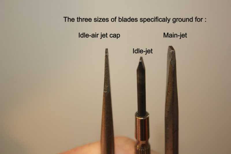

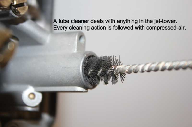

#1 NOTE: There are are number of internet articles regarding the very specific design and machining of fuel jets. These articles state very emphatically that when cleaning jets, attention be paid to not changing any shape to the entry and discharge-end bevels and steps that are specifically designed into the jet for optimum fuel dispersion. This includes the smoothness of the jet bore which is factory "reamed" for smoothness and perfect symmetry - not simply drilled. If in doubt - Replace !
#2 NOTE: The seals on the throttle shaft ends could be damaged if soaked excessively in strong cleaners such as lacquer-thinner. The use of lacquer-thinner for manual surface cleaning and gallery flushing using a syringe is OK.

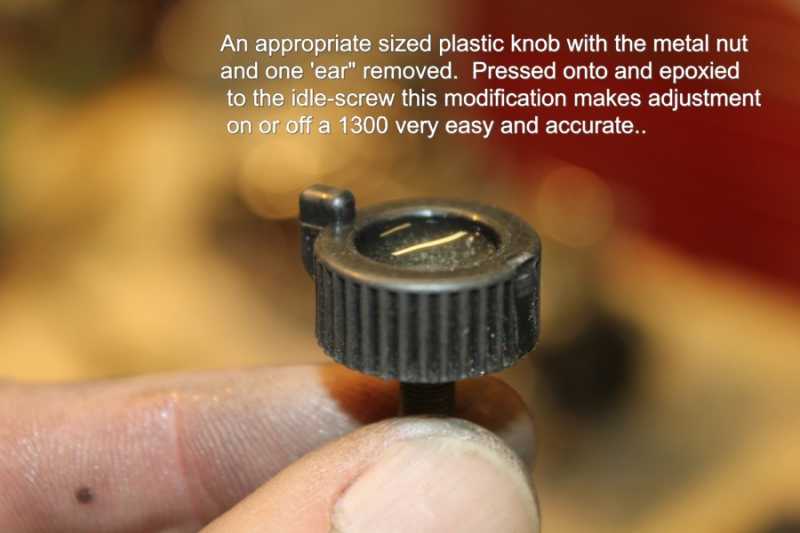

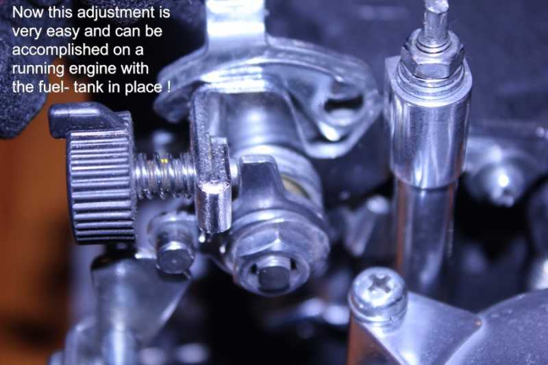

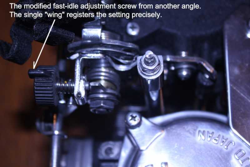

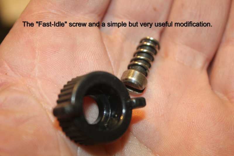

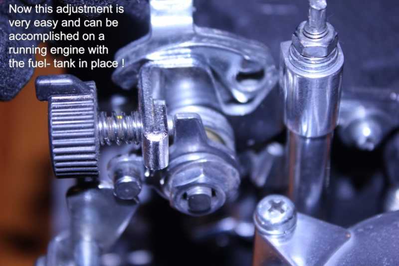

#3 NOTE:When choosing a knob for the fast idle screw mod. it's recommended the dia. not exceed 5/8" to avoid contact with the fuel-tank while operating the throttle. Insulation in the linkage travel area should be removed as well.
