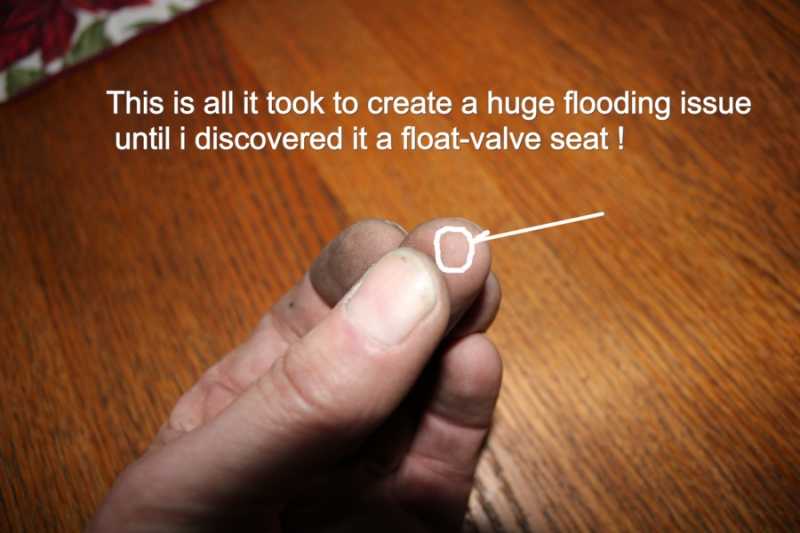

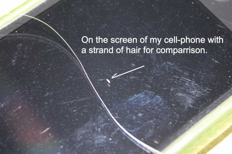

After some substantial time taken to accomplish the work which has been documented on this forum I am VERY HAPPY to announce the'79 carbs were installed on my '80 today and after a few minutes of tweaking, they are running the engine as hoped ( expected) but not without some frustration and anxiety !
Needless to say they are equipped with "the Brass floats". I adjusted the 'throttle sync" statically (by "eye-ball"" along with an arbitrary 3.5 turns on all the idle-air screws. Installed them on the bike and turned on the auxiliary fuel supply and the center carb. started puking fuel like there was no tomorrow !! WTF ! Took them off, removed the #2 bowl and checked the float for free travel. ( Hey - anythings possible , right?)The float appeared OK and with the aux. fuel supply connected to the carbs still on the bench the needle-valve appeared to be OK too ! WTF ! Put things back together and returned them to the bike and voila !.....Another good douching of fuel !!! WTF ! Back to the bench and this time removed the needle-valve. Found a piece of aluminum (see photo) stuck in the valve-body. I can tell you it didn't come from the fuel source as I have 2 filters to deal with this nonsense so I can only conclude that it was from my fuel-line mod. which required the drilling and tapping of the end on the right-hand carb to accept the 1/4" MPT. Trust me when I tell you I cleaned-out this area with enough compressed-air to supply a small planet ! So it goes to prove the point that no matter how meticulous you are - shit can still happen !
And to put another smile on all your faces I'll share this as well: While re-assembling the "demon" needle-valve I dropped the tiny retainer spring ! An hour later I found it - by accident. Dropped it again ! #*"F@!~ ! Not so lucky this time. Fortunately I had a spare valve so I robbed the retainer from it. GUESS WHAT ?
F&%#K)(*&^% ! Another half-hour on my knees with a flash-light but no luck. One last chance: I robbed the only one I had left which was from the bench-carb. I use for making the floats. Needless to say I changed my install technique and got this one on successfully! I'm pretty confident that some time next Spring when I am cleaning out the shop, I'll find both of them, after I've stepped on them and rendered them useless!
Note to self: Make a jig to manufacture needle-valve retainer springs.
Once the nonsense was dealt with the carbs sync'd easily and the carbs are good to go....so to speak.
