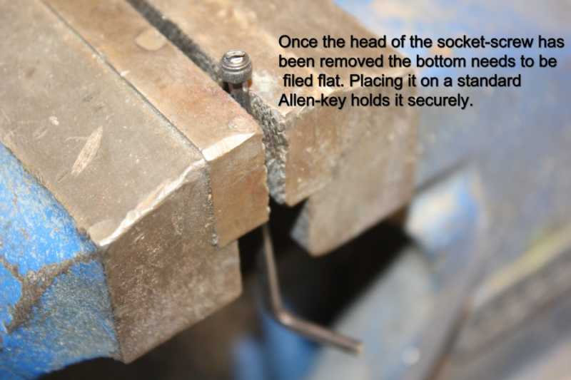

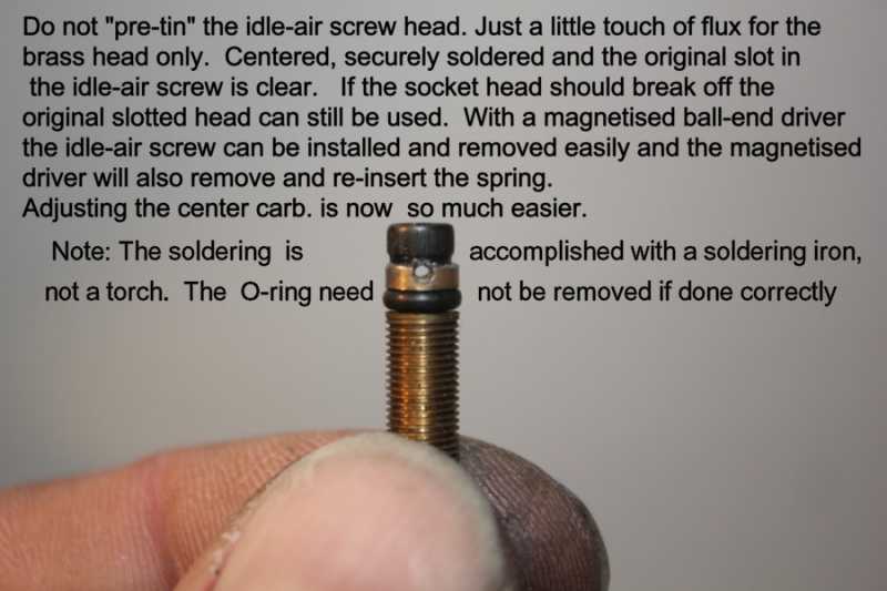

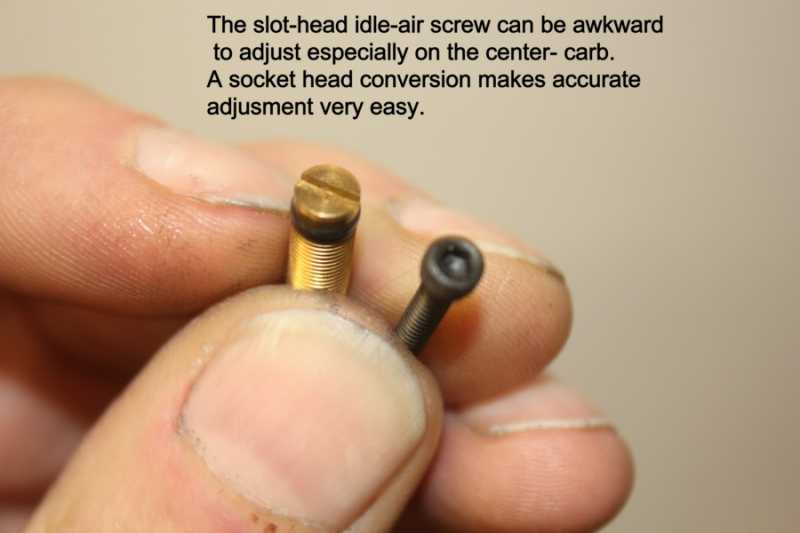

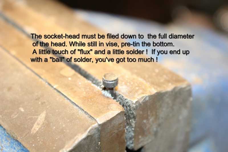

Although I covered this trick previously and having converted my '80 air-screws years ago, it was a "no-brainer" that the '79 rebuild would get the same treatment so here are the basic details. The advantages are obvious.

I've still got standard screws, how the hell do you get to the 3rd screw from the left hand side !

The generally accepted setting for the Pilot-Screws" is 3 - 3.5 turns out. IN leans the fuel/air mixture - OUT richens. This setting will also influence the "Transition" ports (3).
The advantage of the socket-head conversion will become obvious the first time you need to make an adjustment - especially on the Center Carb ! Magnetizing the Ball-End driver will keep the Pilot-Screw on the driver. Care should be taken as the "attraction" is minimal and a "bump" will knock it off and you don't want to drop the Pilot-needle because the odds of it landing on the Tip and ruining it are ......pretty good !
