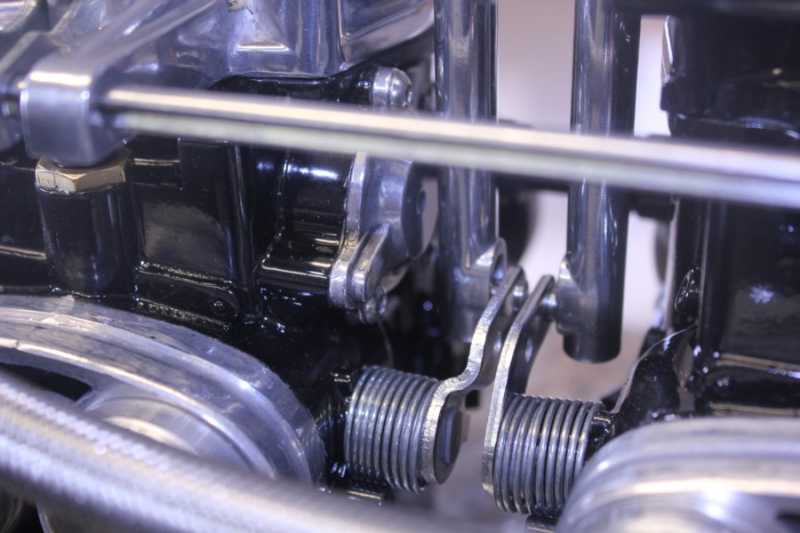

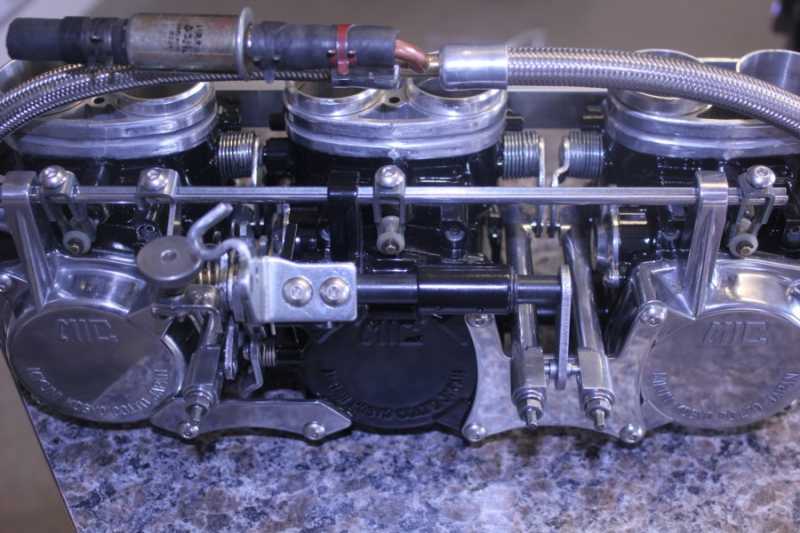

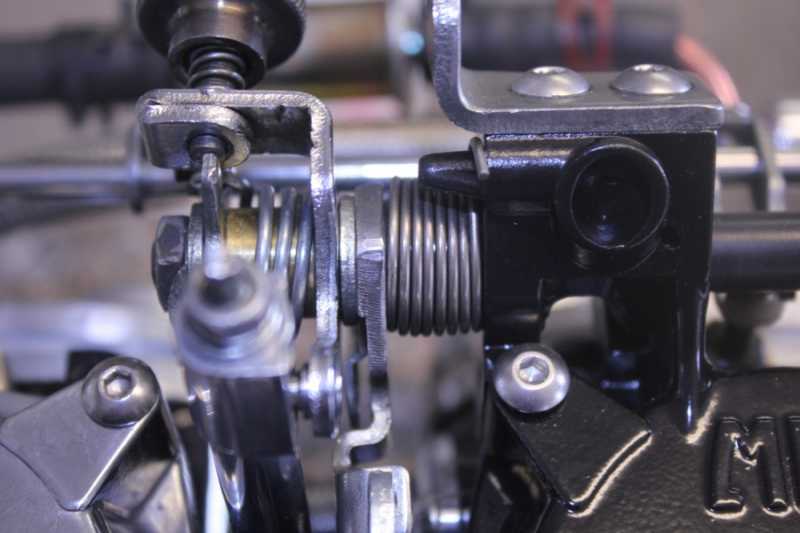

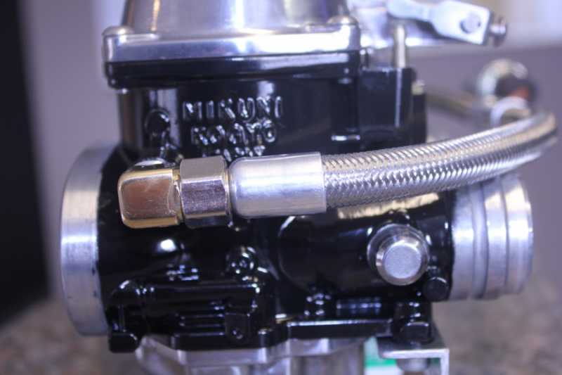

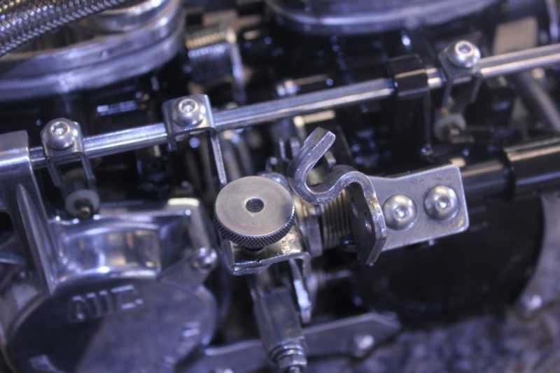

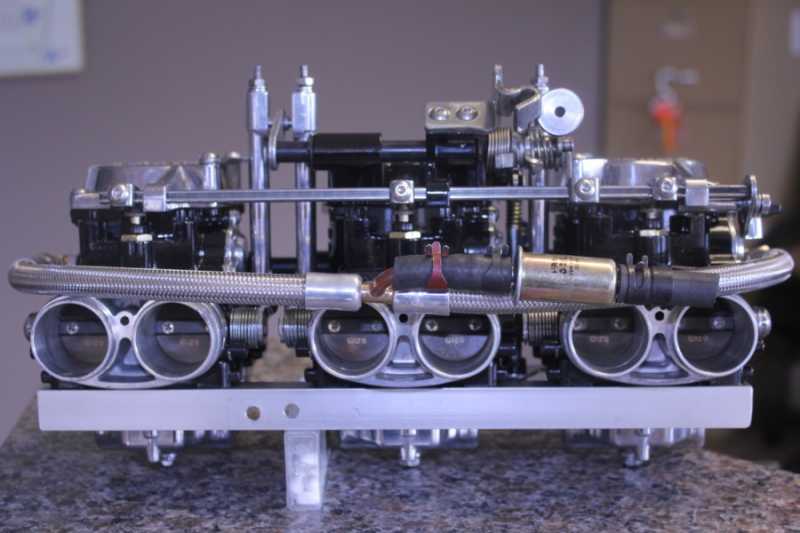

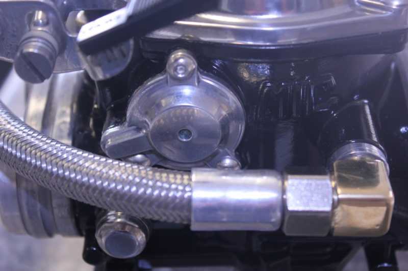

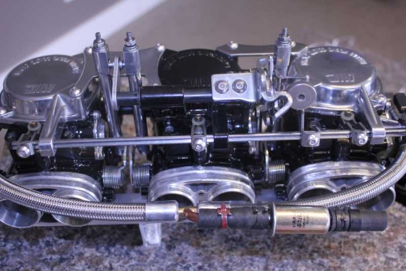

Pictures are of the freshly re-conditioned carbs from my '80. Complete re & re. Where I painted the '79's with a "black wrinkle" I thought I'd go 'gloss" black on these. Hardly a "show" polish" but as an everyday rider it's shiny enough and looks pretty good on a bright sunny day! Frequent wipes with a soft cloth keeps the polished surfaces surprisingly fresh. The "Frankenstein" like socket-heads I had installed 30+ yrs ago no longer appealed to me, so I used S/S button-heads on this reassembly. Soon as the weather warms ( another couple of months
