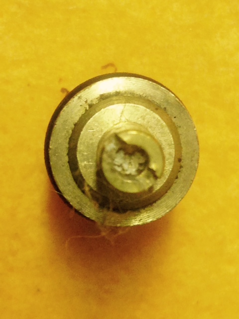

I copied the pump from another members thread, it is not as good but it still works - I used a syringe as the pump.
I checked the butterflies and found that they were not completely closing - I tightened up each butterfly as I went along, this was a mistake as if I just pinched the screw up on both for each carb and open and closed a few times the butterfly centred itself and now they are closed much better. I can however still see some light if I shine a torch through the carb, not a huge amount but still enough to let air through.
I will have to check the jet sizes.
I have stripped the carbs again and found two other problems.
1/ I used instant gasket to seal the air box, this was supposed to be oil and petrol resistant - it is not has I found that it dissolves in petrol and gets pulled into the carb. Had the float closed off the petrol supply this might not have happened but I thought for warned is for armed for other members.
2/ The carbs were perfectly clean after the recent strip down but when I stripped it today I found the jets in the pictures totally blocked, I used new rebuild kits but this looks like it has been there months ?
I am trying to figure a way to get a fuel filter in line but I struggle to see where one could be fitted - any clues would be appreciated.
