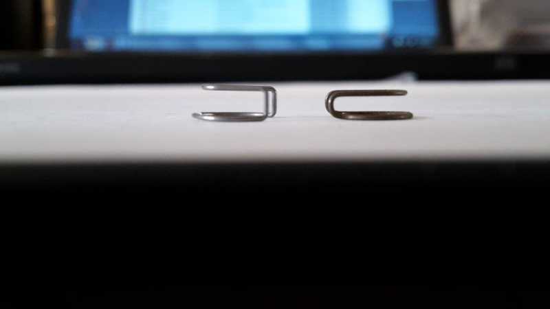

Having said all that, I am going off this weekend on a rally and as my bike has had continuous problems with floading, I decided to check and clean up the ones on the bike. I had major problems trying to get the float levels sorted, the levels tended to be all over the place, when wanting to lower the level, I was suddenly floading and the same when I was raising the level.....bugger!!! After a few hours of cursing and swearing and wishing I had Scotch's floats in had, I investigated deeper.....This is what I found...... Pic below!!
The needle retaining clip from Cruzinimage is a different dimension height wise in comparison to the OEM clip, although very small, it was having an effect on my settings. Sometimes snagging and/or obstructing the float needle tang.
I changed the clips to the original OEM ones.....and waaaallllaaaaa!!!!! Within a short period all was sorted!!!
The clip on the left is from Cruzinimage and measures approx 3.3mm in height and the one on the right is OEM and ,measures approx 2.8mm in Height

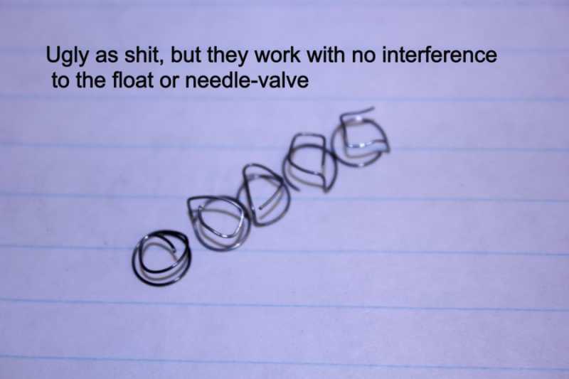

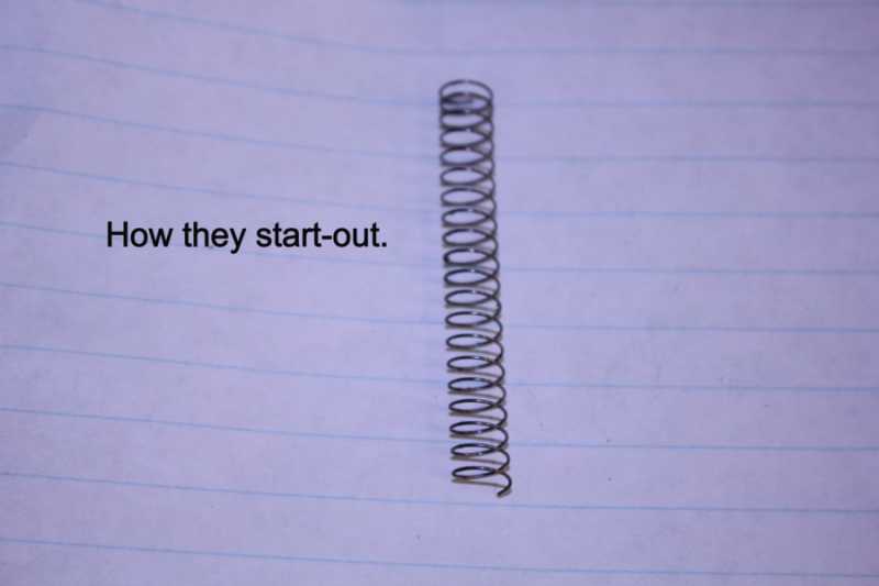

I guess the only point to submitting this would be to show how these could be fabricated anywhere with nothing more then a pair of needle-nose pliers c/w wire cutter.
1st person making any reference to "MacGyver" is on my "NO FLOAT" list. :ohmy:
Despite the obvious variations they all work as intended with no interference to the float or needle-valve. I tested them ! It should also be pointed-out that an equal number went into the can!
Makes you wonder how an (after-market) manufacturer with all the right tooling could screw this up ?
The critical part as I discovered, other then the obvious height concern, is starting with a "spring" that has the correct wire-gauge for the "groove" and the correct O/A diameter so it stays in the groove. Using a NEW set of needle-nose pliers that are tight and have no damage at the tips of the jaws is key to bending accurately. (and the next time I'm out I'm going to buy a set just for this).
WHY ?: My history with these clips "going into orbit" is as good as NASA's however, they have a
better record of getting their hardware back.
I'm currently using 1 of these "alternate" clips in a set of floats. Just saying ..........
