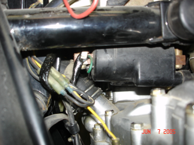

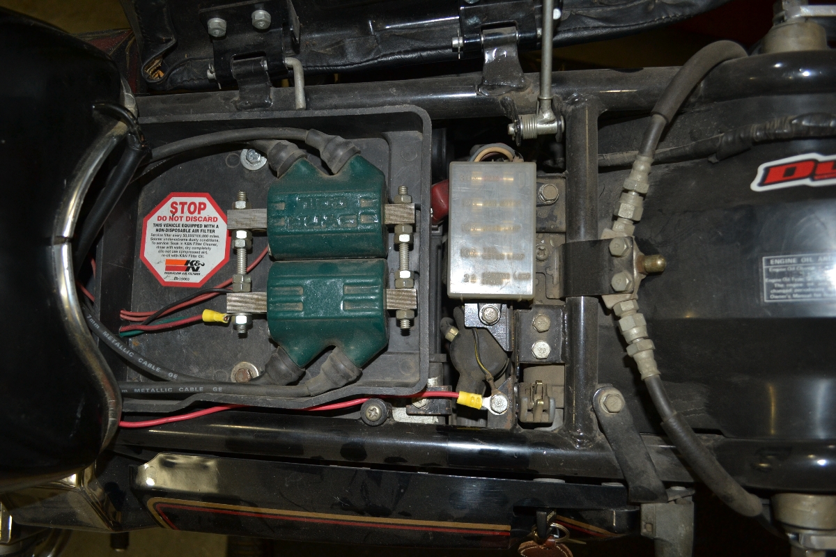

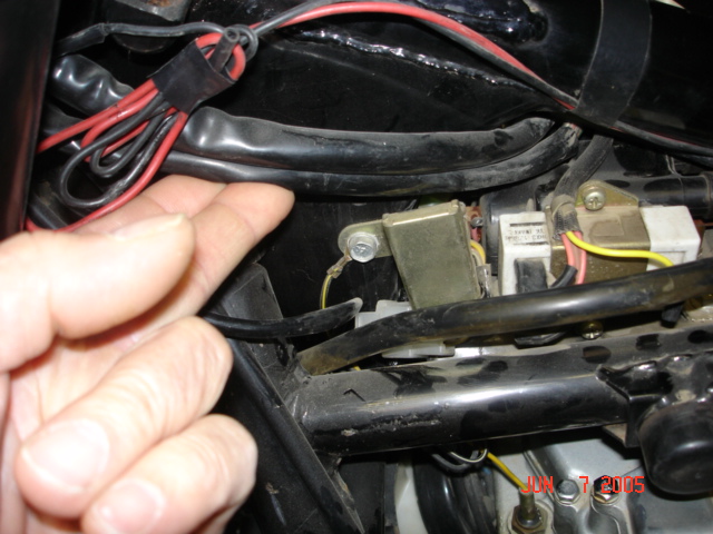

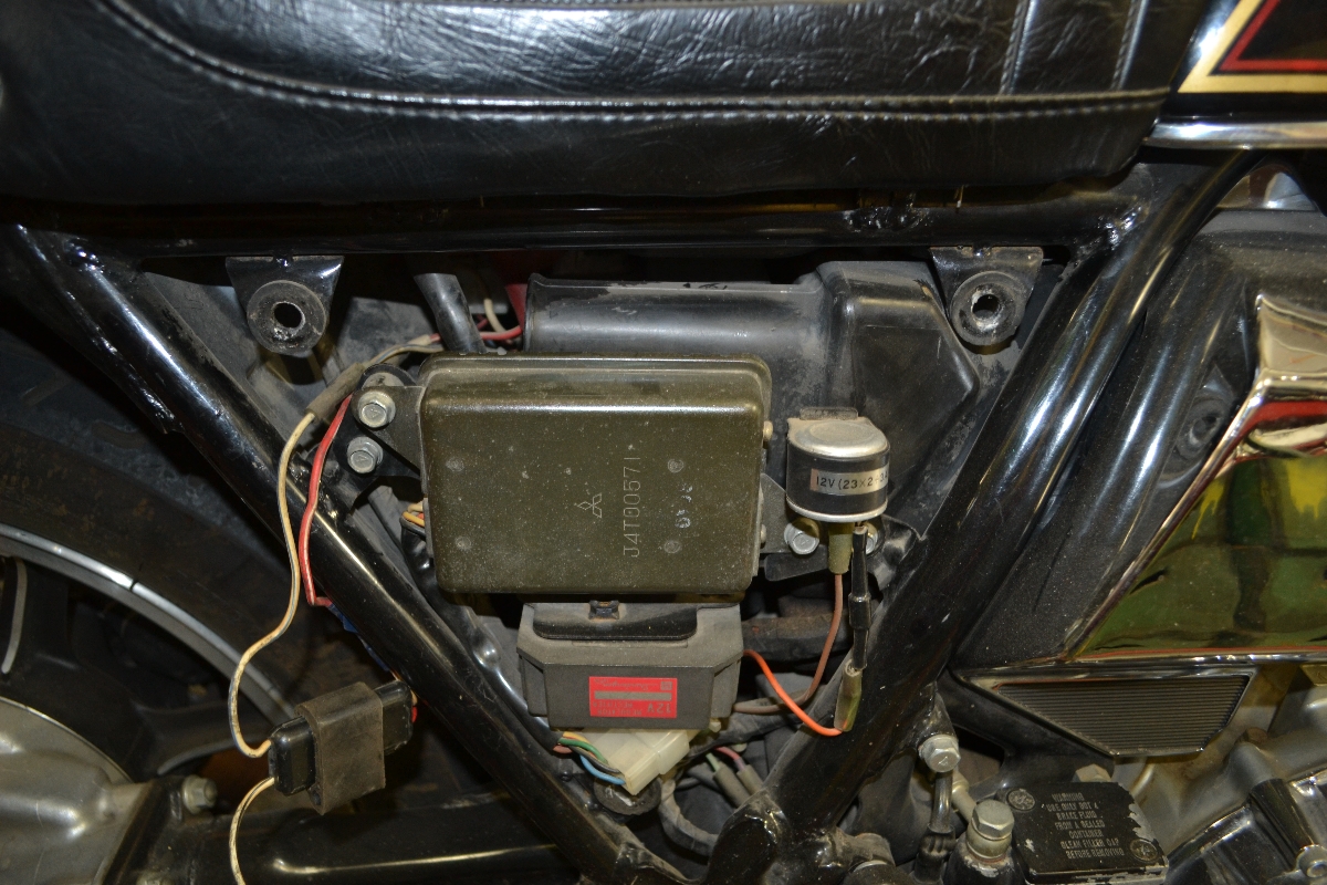

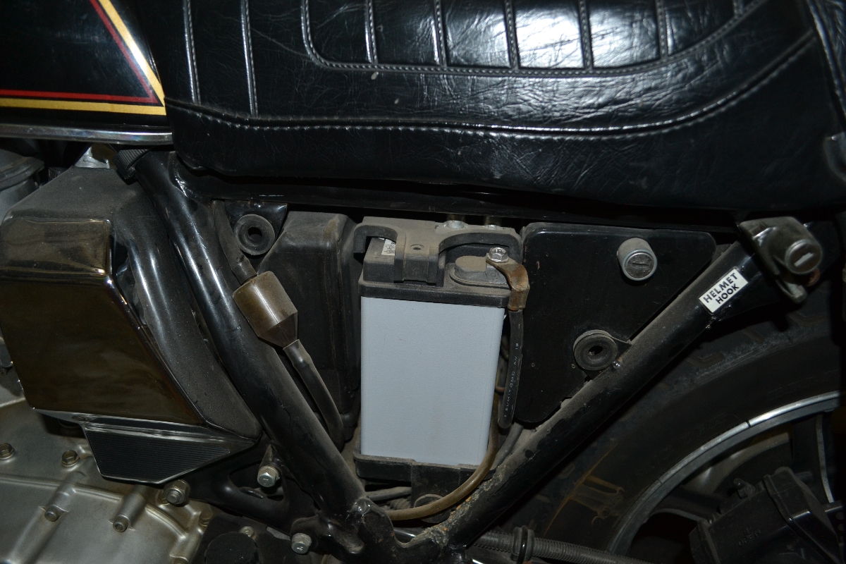

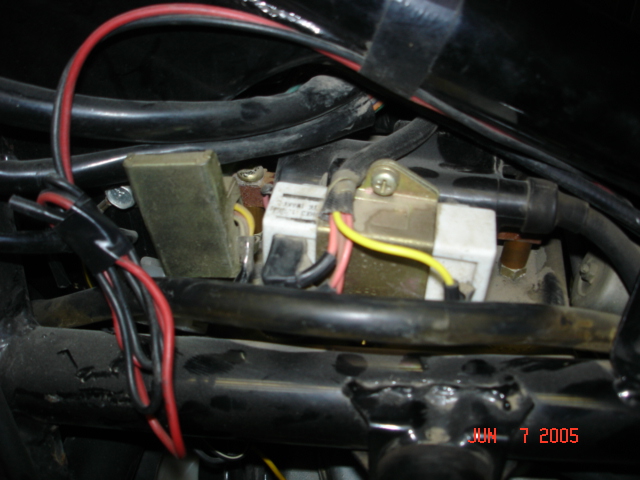

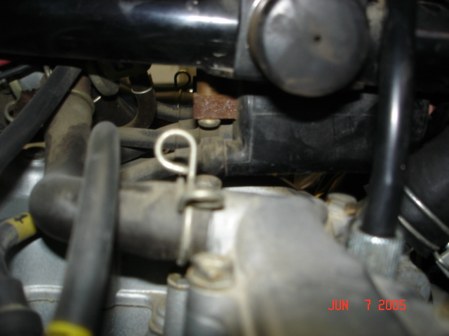

please can someone please photo under the seat and under both side panels as im trying to rebuild the wiring and have lost the photos i took when stripping it down and as many close ups as poss would be very usefull please help cheers all
what colour wires go to the rear brake light switch
and rectifer and the indicator flasher unit ??
zed 13 1979 A1 model

Hi Ed,
I'll take and post some pics after work this evening.
Bill
Bill

as many as you can many thanks ive just ordered a full size wire diagram so that should help too i just need to know where all the stuff fits like fuse box as its been it bits for 18 years !!!

Pic will be better, but here's off the top of my head where the major components are:
-Fuse box is under the seat, behind where the tool tray would rest.
-Igniter is behind the right sidecover, with all the wire connections under it.
-Turn signal relay clips into a rubber ring mounted to the igniter.
-Starter solenoid is to the left of the fuse box (If you're standing on the left side of the bike with the seat open, it's directly "under" the fuse box.
Wire colors are best explained in the manual, and for the most part, just try to match up connectors (if your harness hasn't been too terribly butchered).

cheers bill i wish that someone lived a bit closer to me so could go and compare
