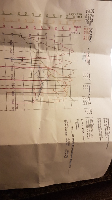

So here is the weird thing. The manual lists the torque at 11.8 kg/m which converts to 85.3 ft/lbs. How the in hell did I get 130 ft/lbs? That is almost 18 kg/m.
Here is the dyno sheet. The sqiggles are from shifting etc.
The KZ always lifts its ass when coming on it hard. Must be the shaft drive setup, yes? Makes sense I would lose a few ponies on the dyno because of it.
