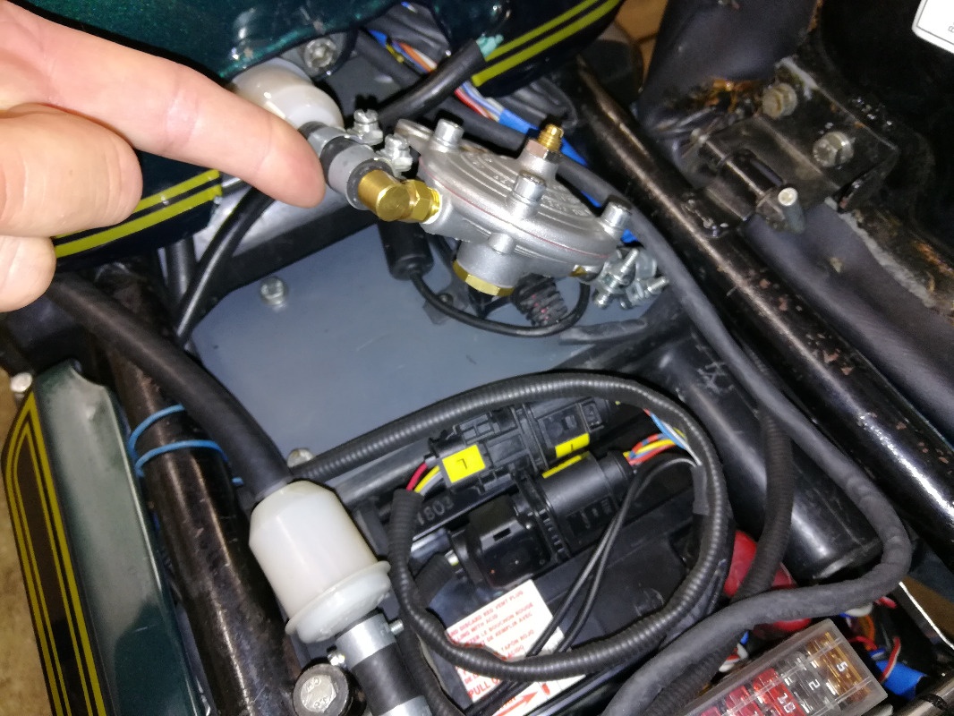

Hi Pete, i had k&n filter when i got my bike and it was like you said one end open whitch goes down and other end was closed and was on the top. Than i replaced this with standard paper filter open on both ends and sponge also on both ends. I than fabricated this cover for the top part. The filter i got from Deb and Oz zet-parts in UK.
