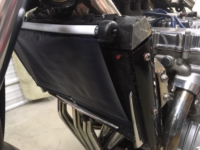

Should be riding in a few weeks but the temperatures will be COOL ! Rode well into Oct. last year. My limit is 10c and for short rides only. With my spin-on oil filter adapter/oil-cooler installed early in '19 I noticed that in these cool temperatures, the temp. gauge( and oil temperature) would barely reach the low end of the operating range.
Came up with this a few weeks before the bike came off the road, last year and it worked so well I'll be using it again, until "Normal" temperatures preclude the need for it and layers of clothing under a snowmobile outfit, scarves and glove liners !

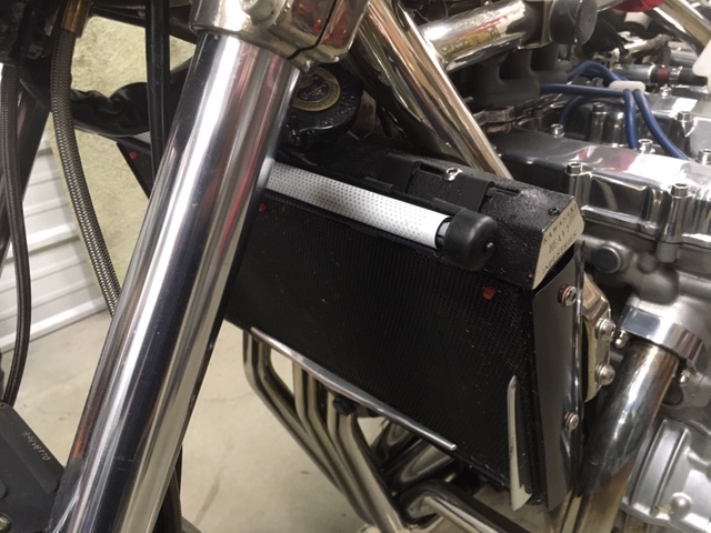

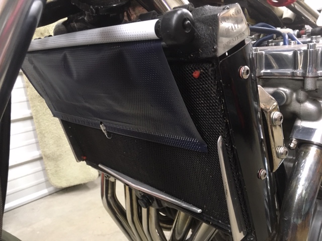

Can be "deployed" and adjusted to cover any amount of the radiator. If it's not recognizable; it's a vehicle window shade. The perforations intended to allow some light to pass through does allow some air to reach the radiator. It works remarkably well. Self retracting and unhooks in seconds when not required.
