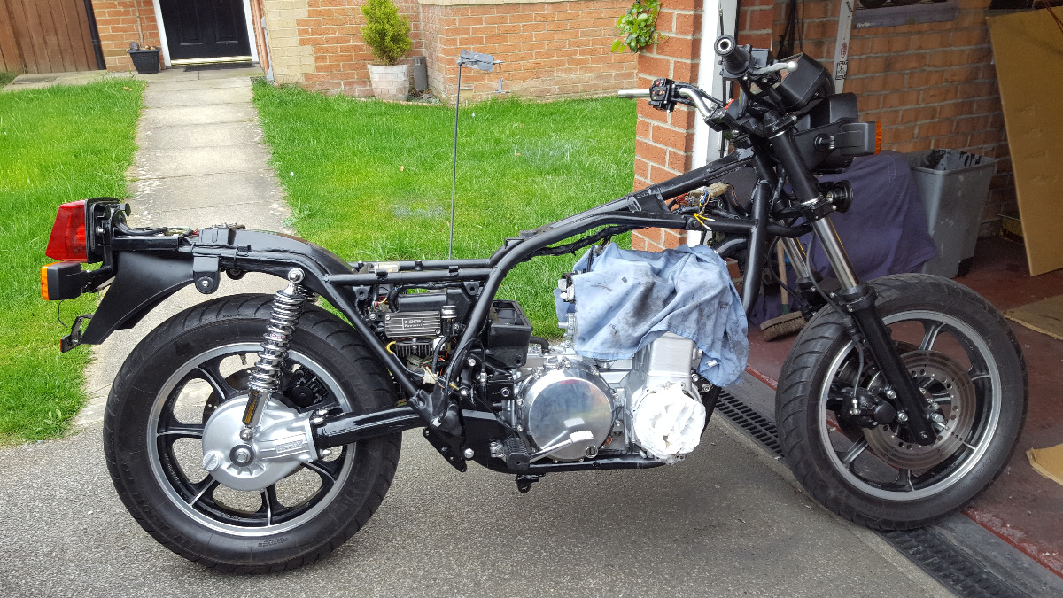

Im in the process of fitting the wiring loom on my 1982 A4, I got it from a friend and it was partially stripped down, I have rebuilt everything and I am just having a few problems routing the wiring. I have got everything working, but I am having a bit of trouble behind the right hand side panel with routing, I cant find any good pictures anywhere that show the way the loom comeback from the engine and found when I went to fit the air box all of the wiring was snagging as there is not a lot of room and there is quite a lot of connectors and wires in the area. , I would be grateful for some pictures or someone pointing me to a previous instruction. there are very few pictures without the side panel and I cant find any with the air box removed to even show if the wiring goes behind or in front of the frame.

Heres a pic of mine as I was rebuilding it and has refitted the harness.
Hopefully its some help and you can save photo and zoom in on it as required ?

Thanks that's a big help , the problem is I had all the wires and plugs connected and I couldn't get the air box in I will have a look at tidying it up , it is always better after a nights sleep I was still at it at midnight last night.

Fit airbox last of all after loosely routing the harness down the inside of the RH side frame tubes.
The majority of block connectors are under and behind the battery tray for the CDI, Fuse Box, Regulator, Ign Pick-Ups, Fan Relay etc.
Nothing on the LH side of the frame other than the secondary ignition lock behind LH side panel, which is fed across from the RH side as well.
