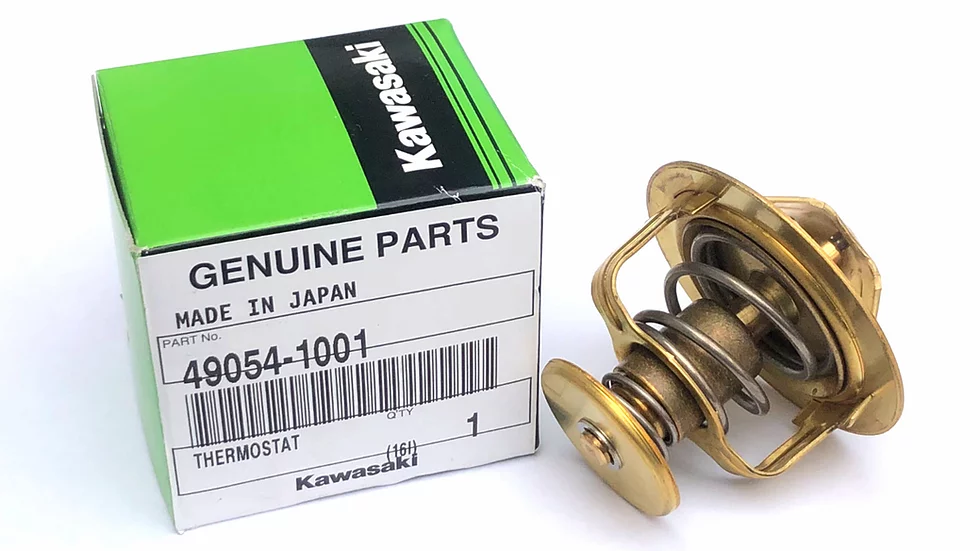

I think that if the outdoor temperature was above 100F, I would believe that a reading on the engine temp gauge near the upper end and back off on power since the coolant system is being strained to maintain the engine temperature. High engine temps when running at 60F outdoor temperature in my mind is an indicatoin that something is not quite right. If you believe the engine temp gauge to be correct, I would be changing out the thermostat. These 2 stage thermostats operate between partial bypass and full bypass. Under normal operating conditions, they are partially open and blend engine coolant with cooled rad coolant thereby modulating the engine coolant rather than exchanging the coolant to keep the temperature at operating temp. It's possible that a weak thermostat maybe regulating the bypass at one of the extreme ends of that operating window.
Your IR checks on the rad indicate a reasonably acceptable rad and you've burped the system enough that you are now able to ride so I have no doubt that if there was minor burping still required, the bike would have done this itself by now. The only thing that could be holding the operating temp at the upper end of the operating range provided the indicator is correct, is the thermostat. I would be changing it out.
This is the thermostat offered by Zed-parts thermostat at 38£ and a pic of that replacement part.
If your t-stat doesn't look like this one, I might suspect a previous owner may have swapped out the t-stat with an incorrect one.

KB, I made that mistake earlier.. Incorrect T-Stat installed. Advertised as KZ1300 but didn't have the bypass portion. The one installed is OEM, and I have another NOS at the ready. Planning to pull the thermostat when doing a complete flush prior to adding Evans Cooling Fluid. THANK YOU for your help!
- dcarver220b
- Posts: 1277
- Thanks: 295
Re: Another 172 miles today
5 years 5 months agoThanks for link, ordered one from Zed-Parts just now.dcarver220b wrote: KB, I made that mistake earlier.. Incorrect T-Stat installed. Advertised as KZ1300 but didn't have the bypass portion. The one installed is OEM, and I have another NOS at the ready. Planning to pull the thermostat when doing a complete flush prior to adding Evans Cooling Fluid. THANK YOU for your help!
