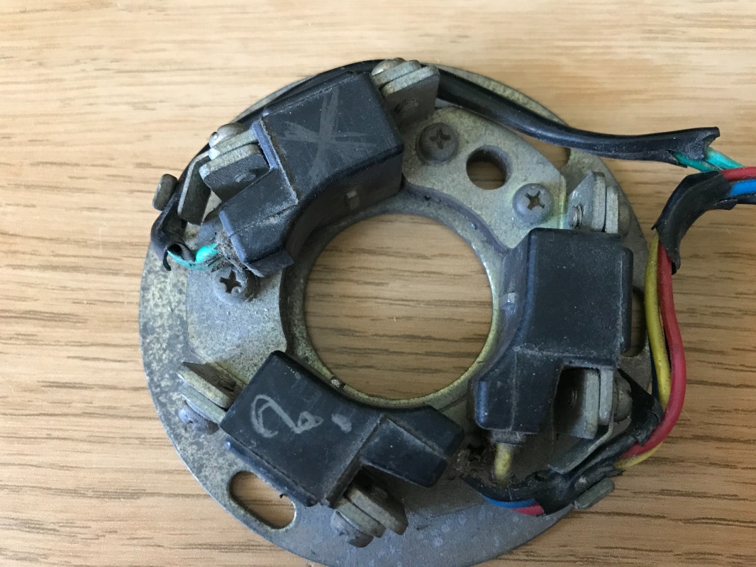

Ignitech.cz is a site where they sell pulse coils. I recall thet they have one that fits A1, A2 and A4

Thanks, looks like a useful site. However, I can't see a direct replacement on their pick-ups page:  Pick-ups - IgniTech Přelouč

On the dimensions page you have the specs, just check there against your current one

Hi Lare,  I had a look at those dimensions but the A1 and A2 pickups all mount to the rear of the sensor. All the ones on ignitech.cz pickups mount below the sensor.  If they are compatible it might be possible to fabricate a new carrier plate?
Also - a little worrying when the dimensions list their properties as resistance/ohms when a coils properties should be inductance/mH

Hi, I looked at the products of Ignitech years ago when we worked on the replica igniter for A3. I noticed then that they have pulse coils, they might be willing to make a small series for A1-A2.
