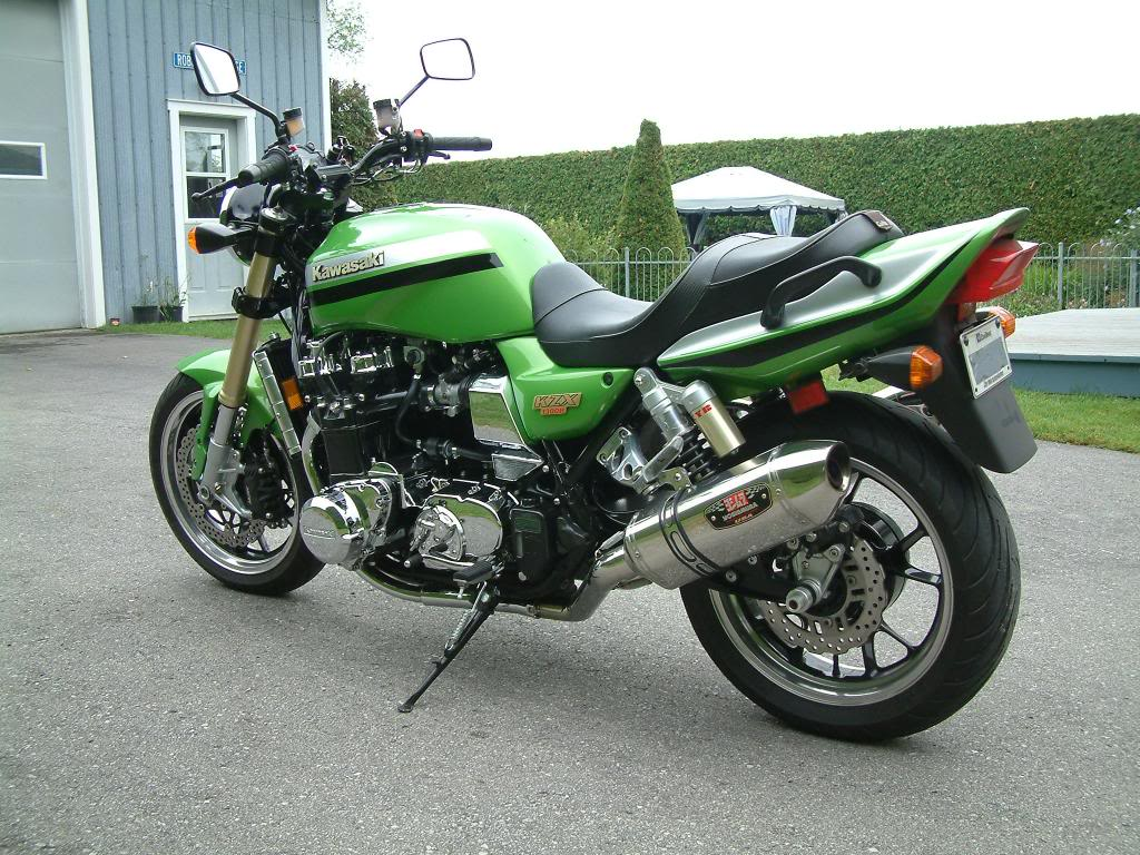

Re: 1980 engine, 18k miles for sale.... stupid, foolish, or great deal?
3 years 6 months agoOh yeah. The idea is to tear it down, complete refurb then find a chassis for it. Maybe some kind of kz sport bike look.It would be interesting to know the history of the engine and why it was pulled from the bike. Engine issue or maybe an electronic issue the owner just couldn't work through. If the engine is intact, $650 is a good price. I would do some investigating before just going ahead and "firing it up". Maybe a top end inspection and refresh if necessary. Along with checking all the usual suspects, such as cam timing, chain tensioner and maybe a scope inspection in the bores. And then a leak down test which could be done out of frame. I would also pull the oil pan and inspect the oil pick up strainer. That's another indicator of what's happened with this engine.
