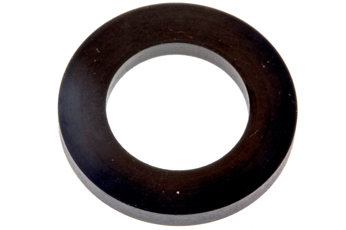

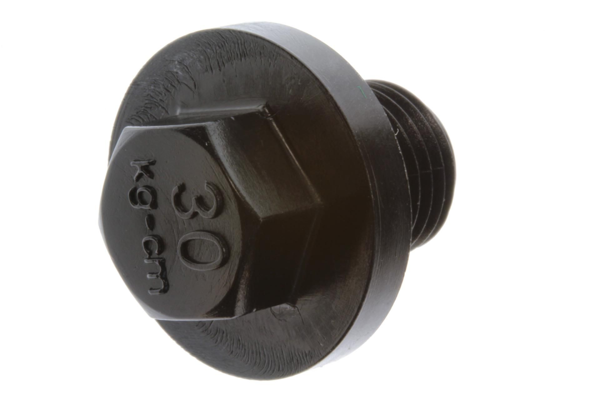

The drain plug has a flange face and there is a rubber gasket washer that seals the drain plug to the rad.
Drain Plug gasket - part# 11009-1152
Drain plug - part# 92002-1682
Both items should still be available at a Kawasaki dealership since they are used on newer bikes

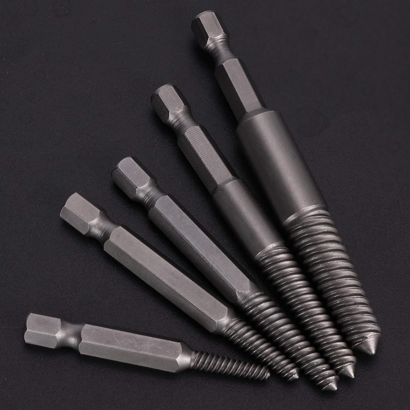

As far as getting out the old plug- drill a hole in the center of the remains of the plug and use a screw extractor
