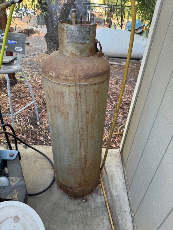

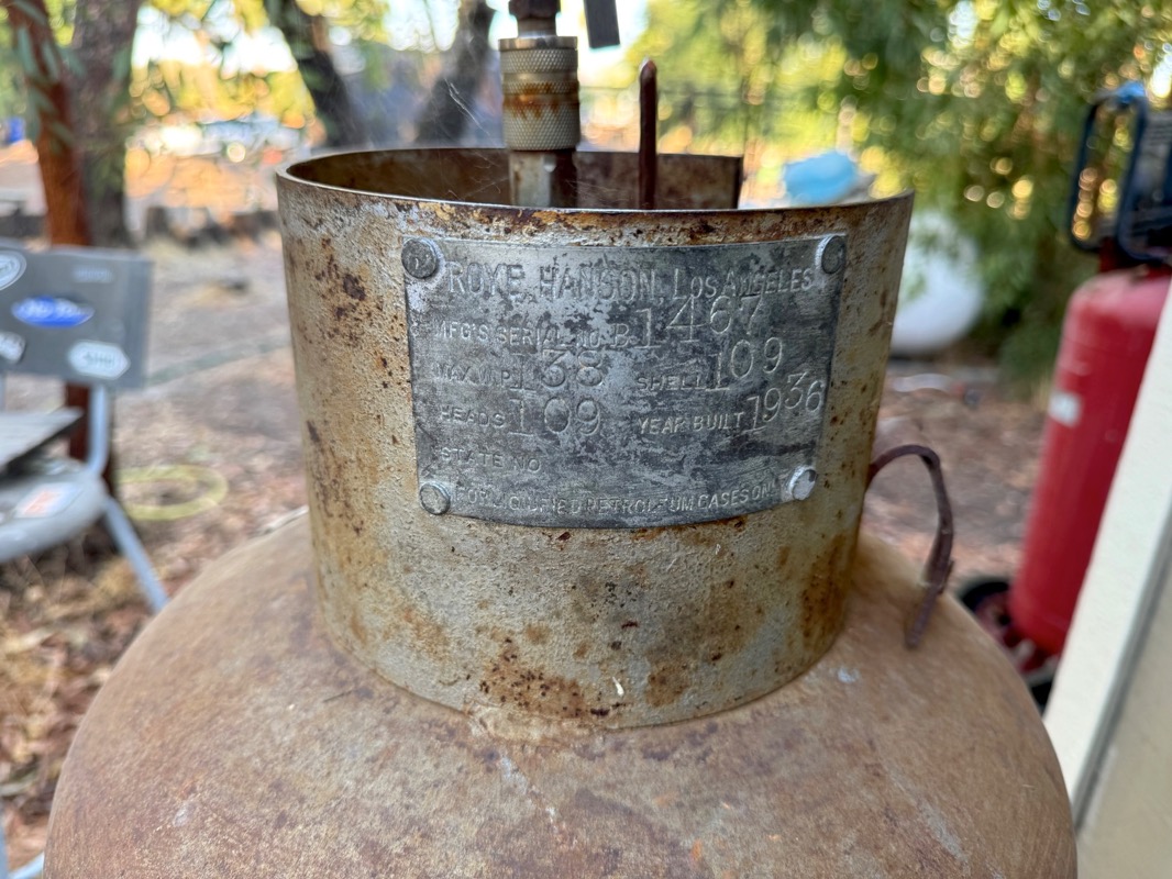

My AC is > 300 feet away... where I have adequate power. For high flow situations, need an accumulator. What to use? Found this... check out the manufactured date!

is it due for its hydrostatic test yet lol
