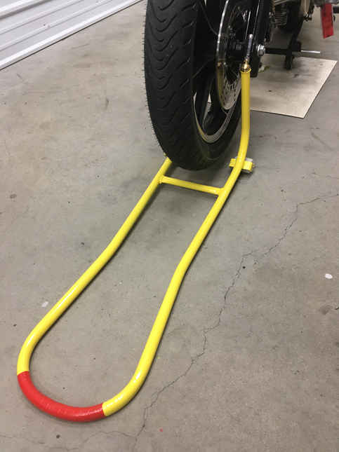

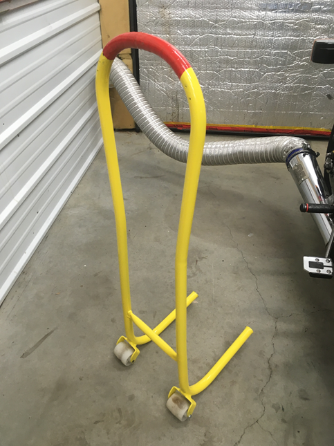

I made mine and it works beautifully. Easy to use and solid. My Nickel Plated Balls
stay on the forks !
It started it's life originally as a cheap (light-duty) hand cart. Cut-out what I needed and welded it up as you see it.
