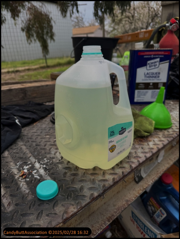

I just did testing today to calibrate the fuel gauge by draining 1 gallon at a time to know how much fuel is really left in the tank.
Will post that up later, I'm tired.

Reserve Fuel, Pingle petcock.
Slightly less than 1 gallon.. might be some left in the tank.. tried 'sloshing' best as possible on center stand..
Just FYI, another data point.
