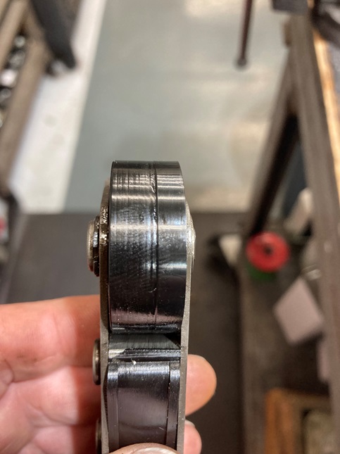

This is the Roller from my recent '79 project.  It came with a ZX10 tensioner.  20,000 Kilometers on the odometer and last insured in 1994 !!
There is little doubt that the "pattern" on the roller is from sitting for so long with this tensioner's excessive spring pressure.  The asymmetric pattern is a mystery and I won't speculate.

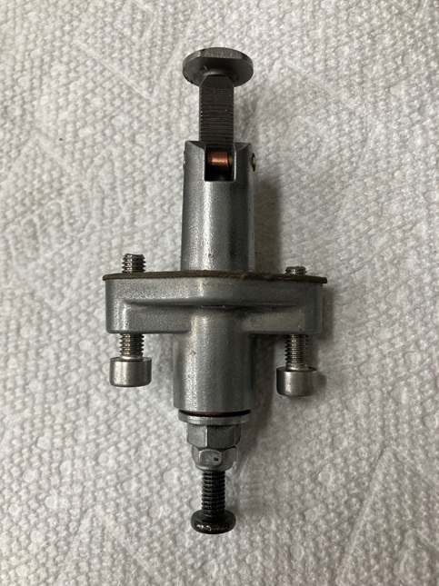

I modified the ZX10 tensioner by installing a "lighter" spring and by removing the ratcheting awl.  In place of the awl I put a piece of brass tube in its place to prevent the rod from coming out.  I prefer to have the rod "floating" and not being "locked" into place.  With the rod floating I can back-off the adjuster (and the rod) for adjustment purposes. and to allow for the "full feel" experience.

Hi Scotch,
Am I correct? As modified, you turn the end bolt in until you can feel the tensioner through the spring and then lock it down with that nyloc nut. By 'through the spring' I mean that even though it's locked down it still floats with the spring pressure.
Thanks
Bill

That's correct Bill. "By Feel" is subjective for sure.  I adjust until there is a "firmness" felt and then back-off a bit.  "A Bit" is also subjective.  I also make this adjustment by "the sound". Essentially: Not too tight and not too loose. It's pretty obvious once you've dialed it in and out a few times.
