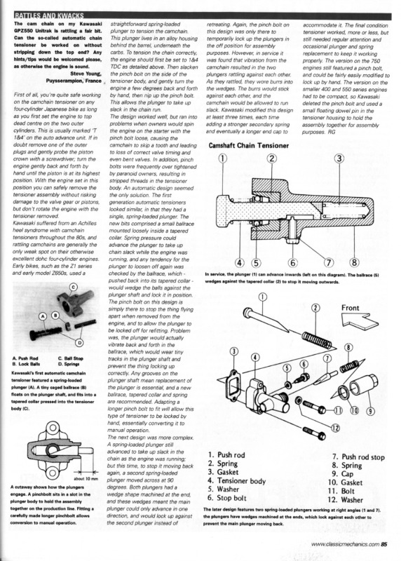

gd4now, one of the members over at KZR, posted this about cam chain tensioners. I think it's good and historical information:
