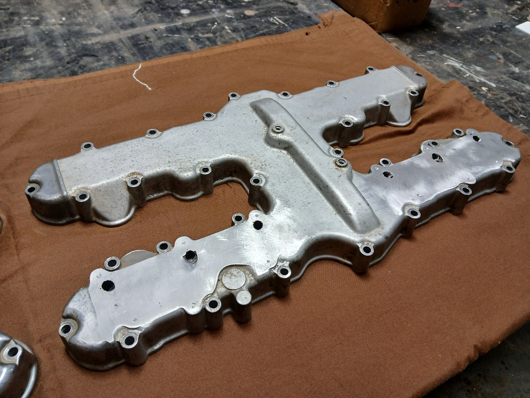

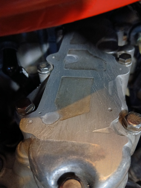

Scotch recently mentioned that he'd machined the reed boxes from atop his cam covers. He reported that he'd filled the passages that connect the reed valves to the exhaust ports with a high temperature epoxy. I'd thought about doing the same but I'd envisioned welding up the port openings and was worried that welding might cause the casting to warp.
Coincidentally at that time I had the cam covers off of a '82 KZ1100 Shaft and an '85 ZN1300 for valve adjustments.
I just couldn't resist, 'Off with the Reed Boxes!'

Also while I had the cam cover off I took note of Scotch's mention about machining off the exhaust gas recirculation chambers and filling the ports with high temperature epoxy. Something about imitation and flattery there Scotch, Thanks.

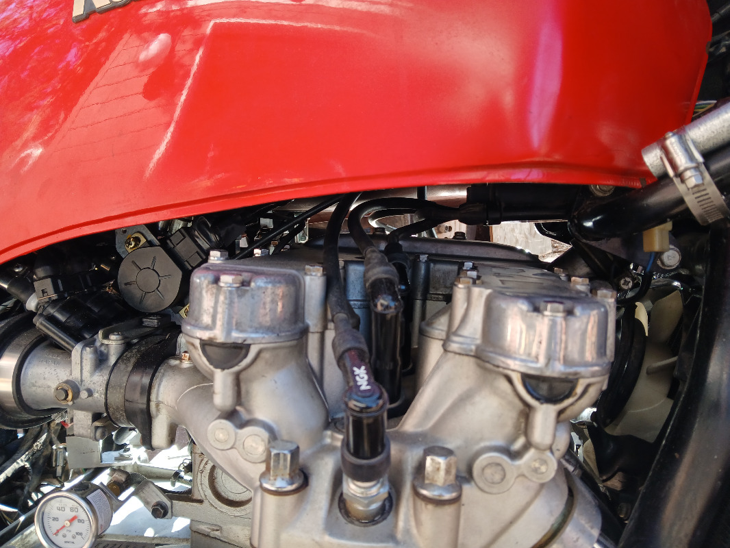

Check out the clearance between the cam cover and the fuel tank.

It was actually relatively easy. I fitted a carbide tipped wobble type dado cutter to a 10" radial arm saw. The wobble was set to it's narrowest, 3/16". I adjusted the cut height carefully and made the cuts on the push stroke only. The first results were rough but true enough so that an hour's filing and some sanding made me happy. So far I've cut down two other cam covers this way as well.
On this one I left enough of the reed boxes to remind folks of them.

Apparently both of the engines I've done this to did not have mechanical tachometers. If you look at the first picture in this thread you can see that cam cover for the '85 ZN has the boss that was just not machined out to accept a tach drive.The top of that boss is about 1/16" below the plane needed to completely remove the box.
