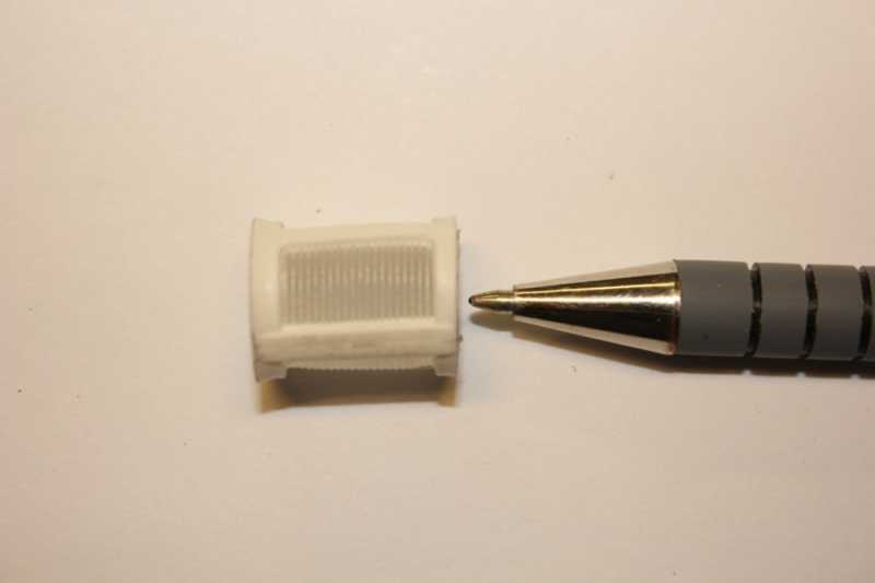

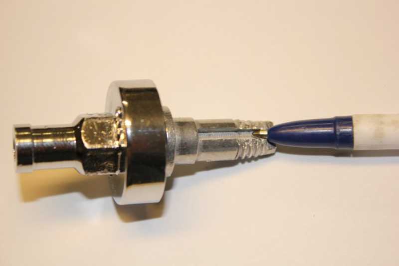

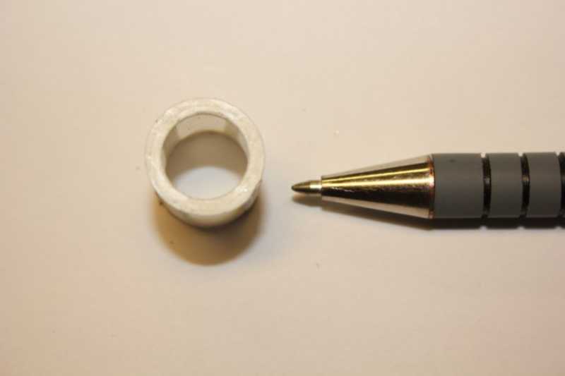

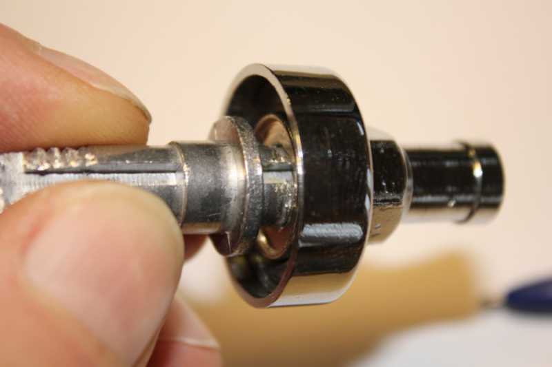

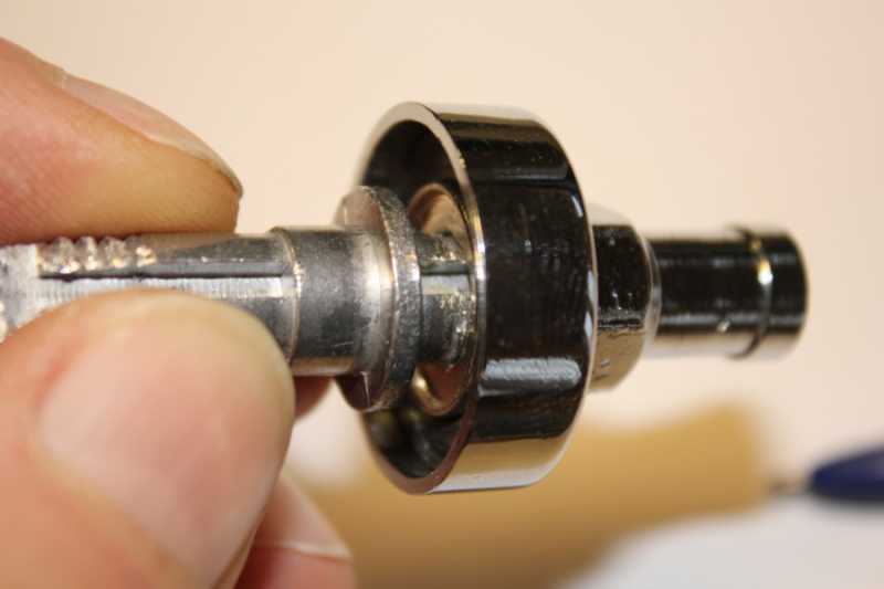

received two fuel filters today after a 5 week wait. Waste of money ! Threads are are 'cast" not machined. Both were assembled misaligned. Designed to be disassembled for cleaning, both were difficult to undo and discovered the threads were full stripped both ends on one and one end on other. Strait into the garbage can.
Don't waste your money !

It's amazing to me how crap like this can be sold. Hmmmm........Cuz suckers like me buy it ?
I doubt kza13s' bike quit due to fouling from:shitty gas or effluent ? Oooooh ! Harsh !

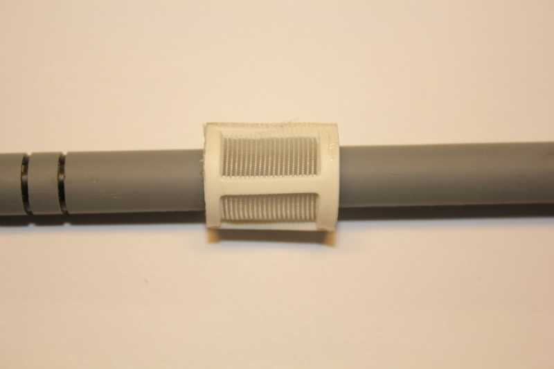

Besides the puny filter cartridge look at the ridiculous little 'grooves" intended to flow the fuel in and out and try to convince me that this filter would be able to supply fuel to anything bigger then a lawn-mower.

Scotch, what about simply machining up a new set of ends to fit the glass and filter? The filter looks OK, and so does the glass. How parallel are the ends of the glass?
