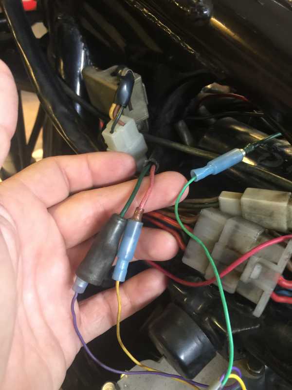

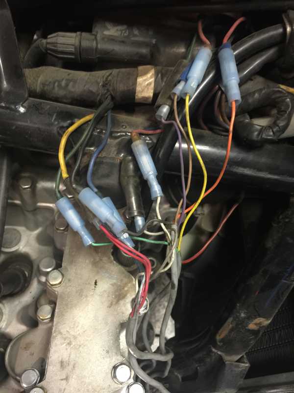

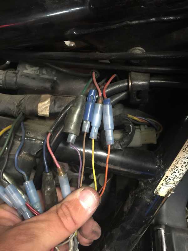

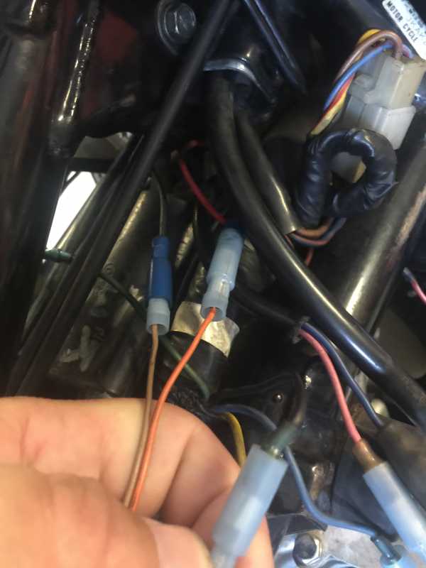

Need to get power to the coils. the wiring is mess. each coil has the two wires off of them. which is + and which -? each coil wires are different colors. Can anyone make sense out of the pics and steer me in the right direction on where/how to pic up power?? (left side red/green) (center red/black) (right blue/red)Right now the wires attached to them go nowhere and end just outside photo.

All pink wires are the negative feed to coils. Green wire to feed positive to 2-5, black positive to 1-6, blue to feed positive 3-4.
All pink wires should be connected to the yellow if you've removed the ballast resistor.
Looking at the wiring in your photo's been messed around with big time?

Fired right up and runs perfect! thanks, this was so much help!
