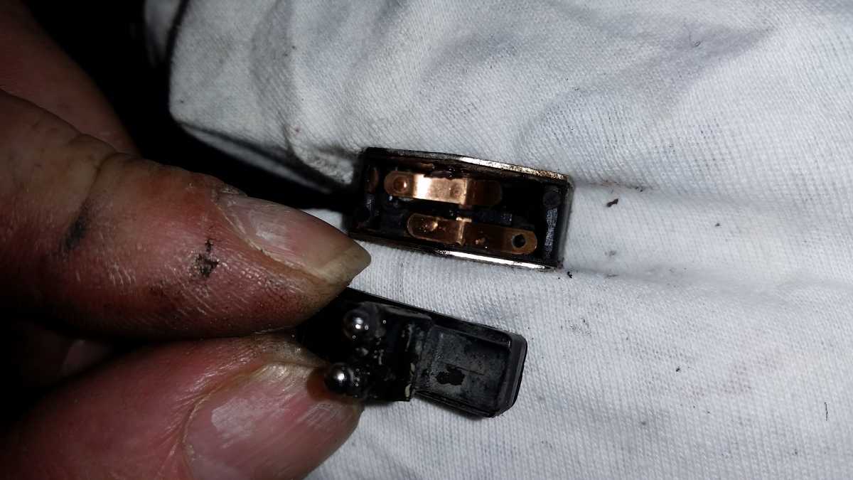

My "new" 79 had a bad engine shut off switch, as well as a bad starter switch.
My "old" 81 had a good engine shut off switch and an intermittent starter switch.

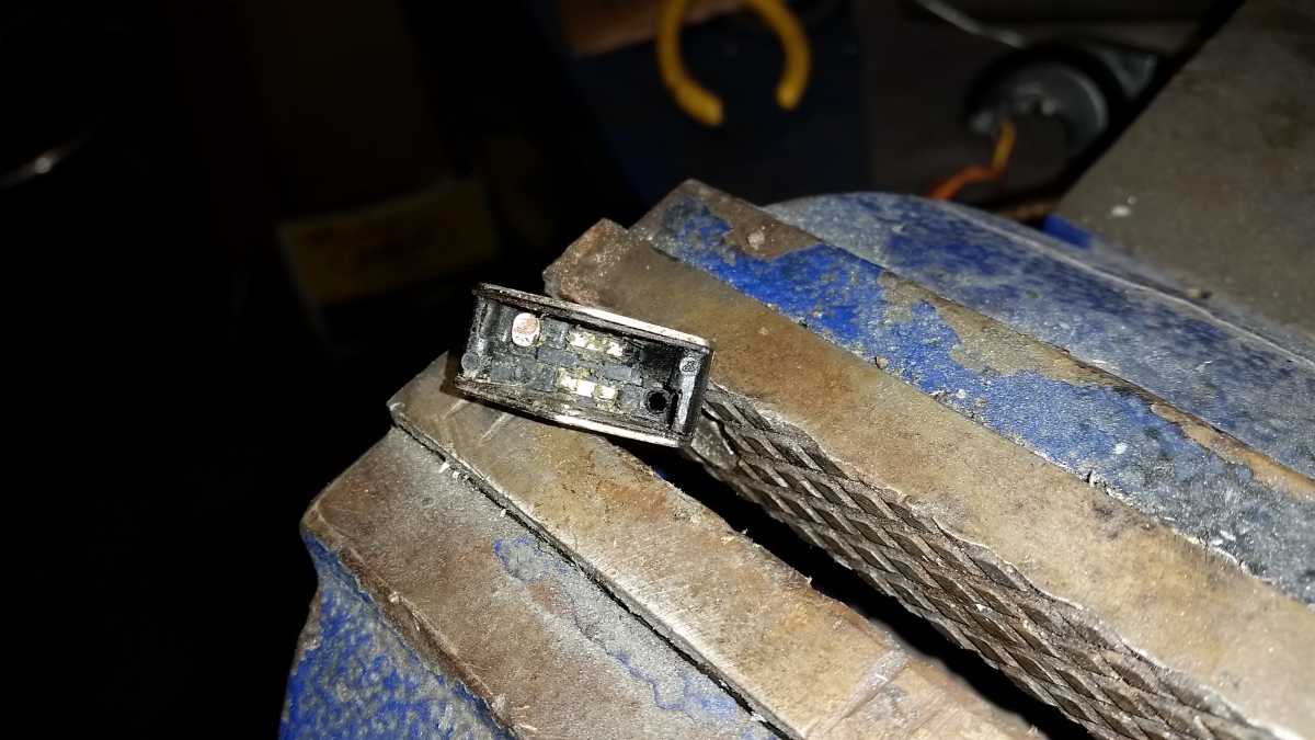

I decided to fix the 81 starter switch and put the whole thing on the 79. The starter switch repair went well. It was filthy, as well as had some frayed wires where it comes out at the handlebar.
Cleaned up and ready to reassemble. Tested both at the plug and was well.
