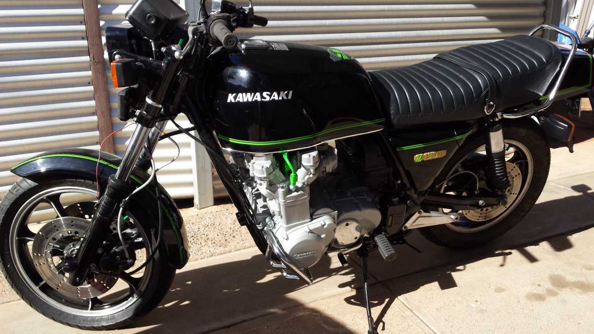

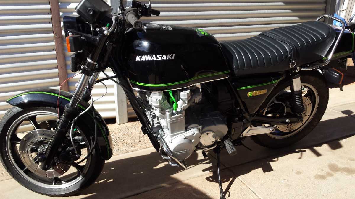

Thanks folks, will give it another try today, thanks for the helping hand..
Still a work in progress .. waiting for the 6 into 6 exhaust system.
