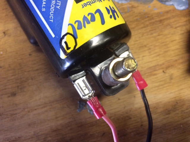

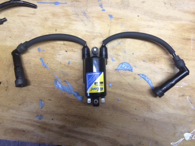

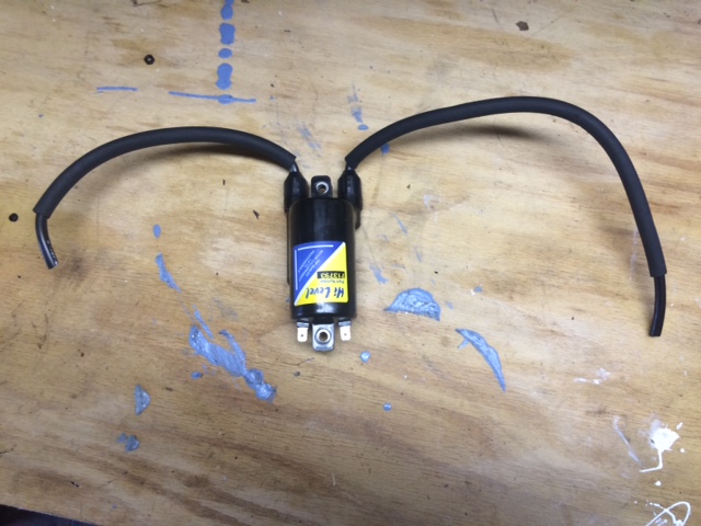

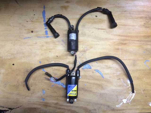

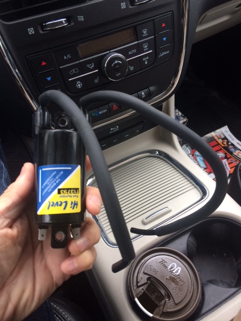

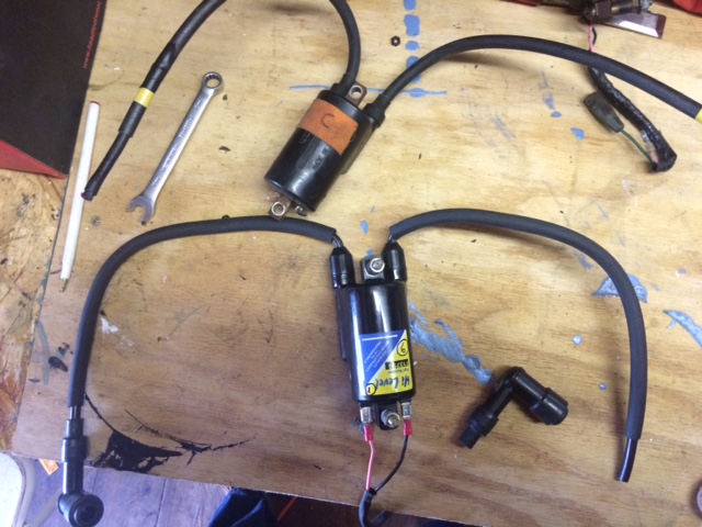

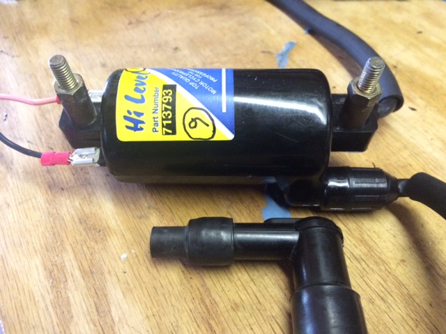

I received the ignition coils and they were right, they are a direct replacement without any modifications. They will bolt right on where the old ones were. Mine were the originals that have the plug wires bonded to the coils. I cut the 2 wires off my old coils where they were soldered and put crimp connectors on them so they slide right on the new coils. I unscrewed the spark plug caps from the old wires and screwed them into the new wires. The new wires are replaceable but were perfect length. Each new coil came with a long plug wire and a short one, so I had to put 2 long ones on one and 2 short ones on another but they all reached just fine. I bolted them on and the bike fired up great. I took it for a ride for 10-15 minutes with no problems. Unfortunately, I am in the process of moving to another province so will be unable to go for a long ride for a while to really see if the stalling issue is resolved. But I'm happy that it's running now since it wouldn't even keep going when it was warmed up before.
