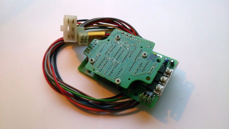

I find this statement offending. Our ignition module for the 1981 A3 model is a reproduction of the original Mitsubishi Electric module.
It was reverse engineered by a brilliant Estonian who used to build rocket control boards for the Sojuz space rockets. The units have been manufactured with modern components and each unit has been tested in test bench and on Aris bike. We have supplied ca. 50 pieces of them around the world and thus have kept the bikes on the road for years to come.
They are definitely not "Slapping it on and seeing if it works"
As to using aftermarket coils in the 1300s, I know the working parameters of the igniter from the development and testing of our units.
The igniter can handle an ohm range of 2.4 to 4 ohms without fear of damage to the output transistors.
I run my KZs with ordinary after market coils with 3 ohms on primary, the ceramic resistor is taken off. My stock engine on the 1982, which I fully reconditioned 20,000 miles ago, gives out 112 hp from rear wheel with those coils.
