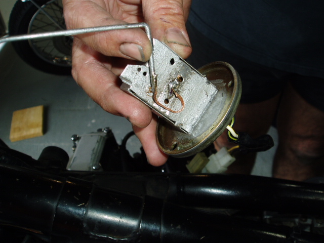

zed parts in the UK sold me a second hand one with a video to show its working.I also have had my old one fixed by a instrument shop. They can rewind them .

Hi i will try the second hand one turned up but didn't work and the one i had fixed leaked again.Zed parts said to return it for a refund but i needed it opened it up and tested it wasn't earthing.Sent them both to my local instrument shop and he added a earth strap to it and its all good.THE other one that leaked hes has put two rubber washers to seal it .Finally got to ride the bike again but its not idling on all Cylinders
